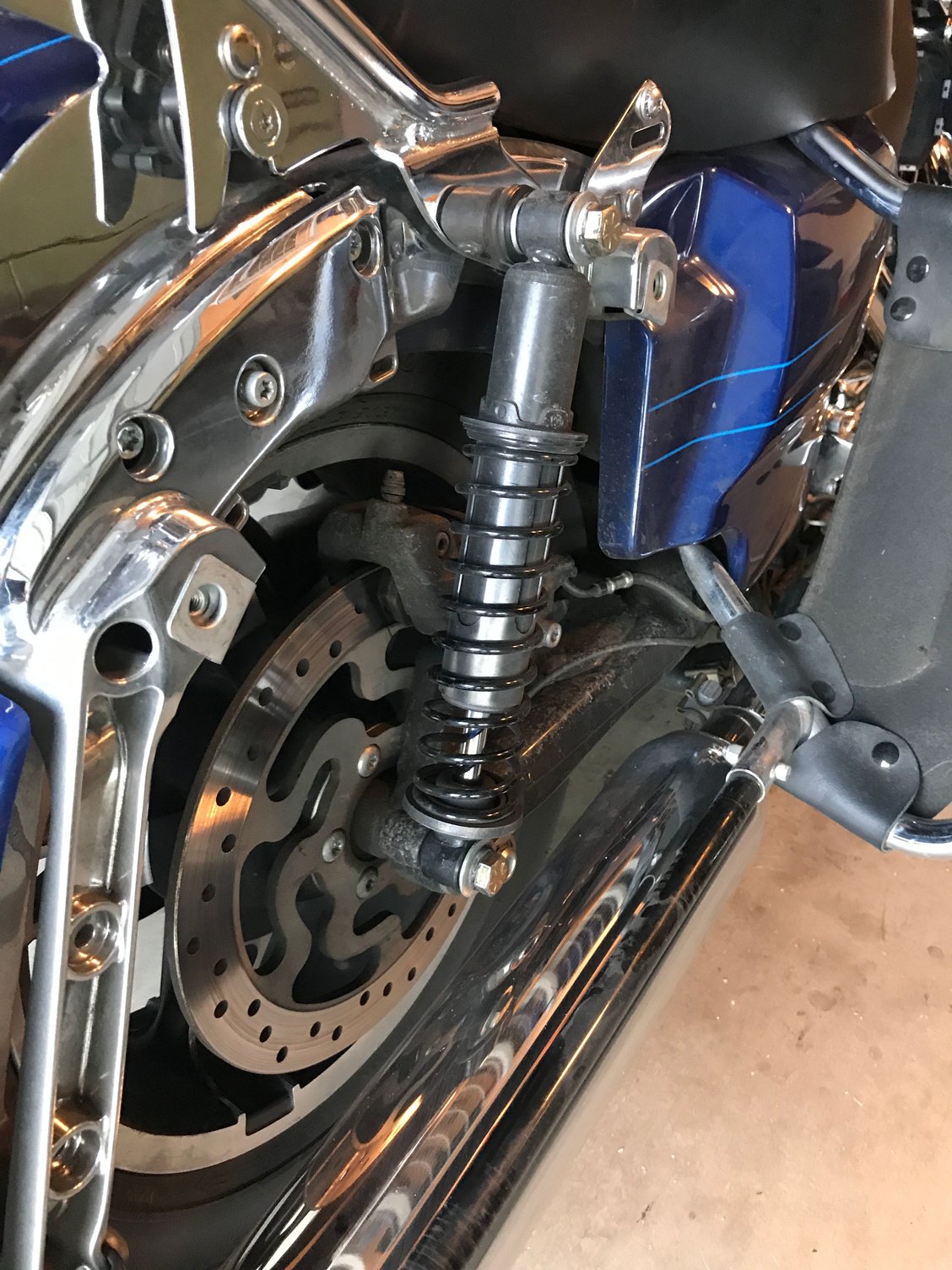

My shocks look like these, they are 13" though. These are not a picture of my actual shocks, but mine look exactly like these. They have been on three bikes now, a 2009, 2012 and my current 2014. I bought them used here on this forum in 2011 or so. The 2009 and the 2012 both had quick release docking hardware, and quick release backrest and luggage rack too. My shocks do not have the big bare portion shock tube like in the pics shown here, my spring goes all the way, and covers up all of the right shock.
I'm really not sure what this means, just sharing what I have on my scooter.
Thanks

My shocks are the OEM take offs from a 2016 RG, 12". The right shock does NOT look like this pic. My R/H shock looks looks like azdrumbles pic. There a different shocks, I don't know who gets which R/H shock.
