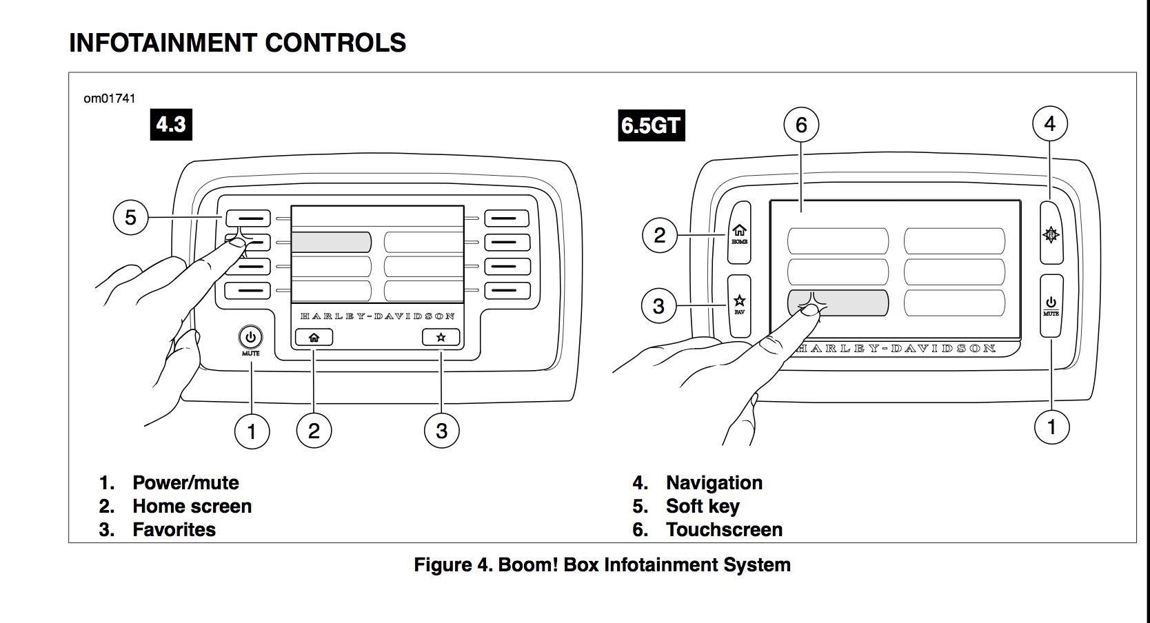

Is there a power button? I see a home button..... Am I missing something?
Power/mute button. The lower right button.
Straight out of the Boom owners manual.
#1 in the picture below.
