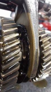

Well, here it is. Man it's ugly. Here is what I was told, "Shifter fork bent, trashed shifter collar and third gear, new mainshaft as well. Essentially a full rebuild."
3rd gear trashed
