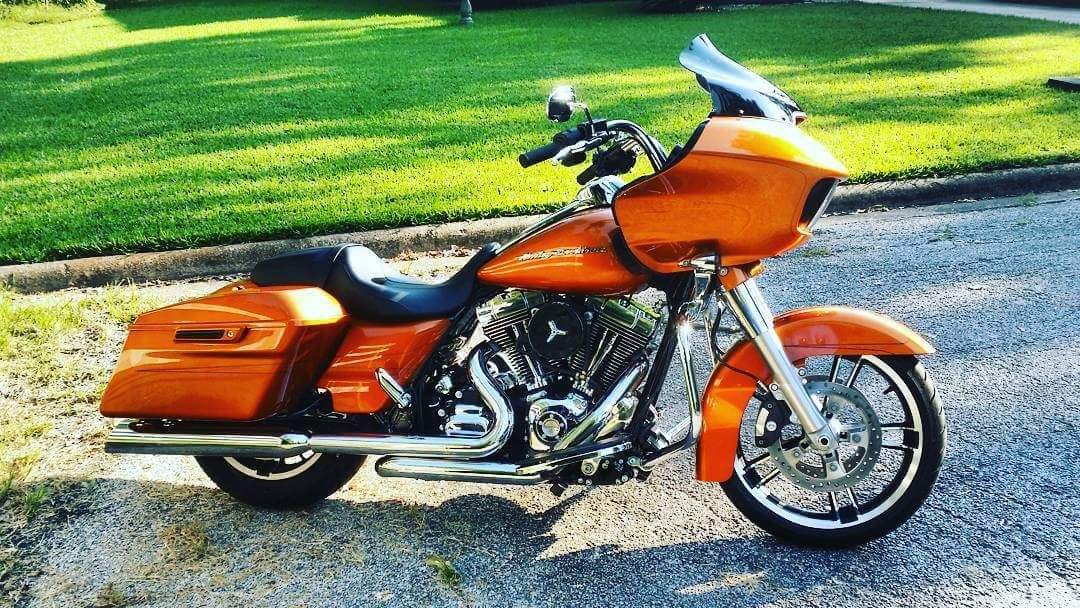

I installed some woods 777's in my 2015 RGS and now I am clatter in the throttle body at idle to 1800 rpms. I've this is a hit or miss issue with installing cams. I can't find any solution on line, any ideas?
