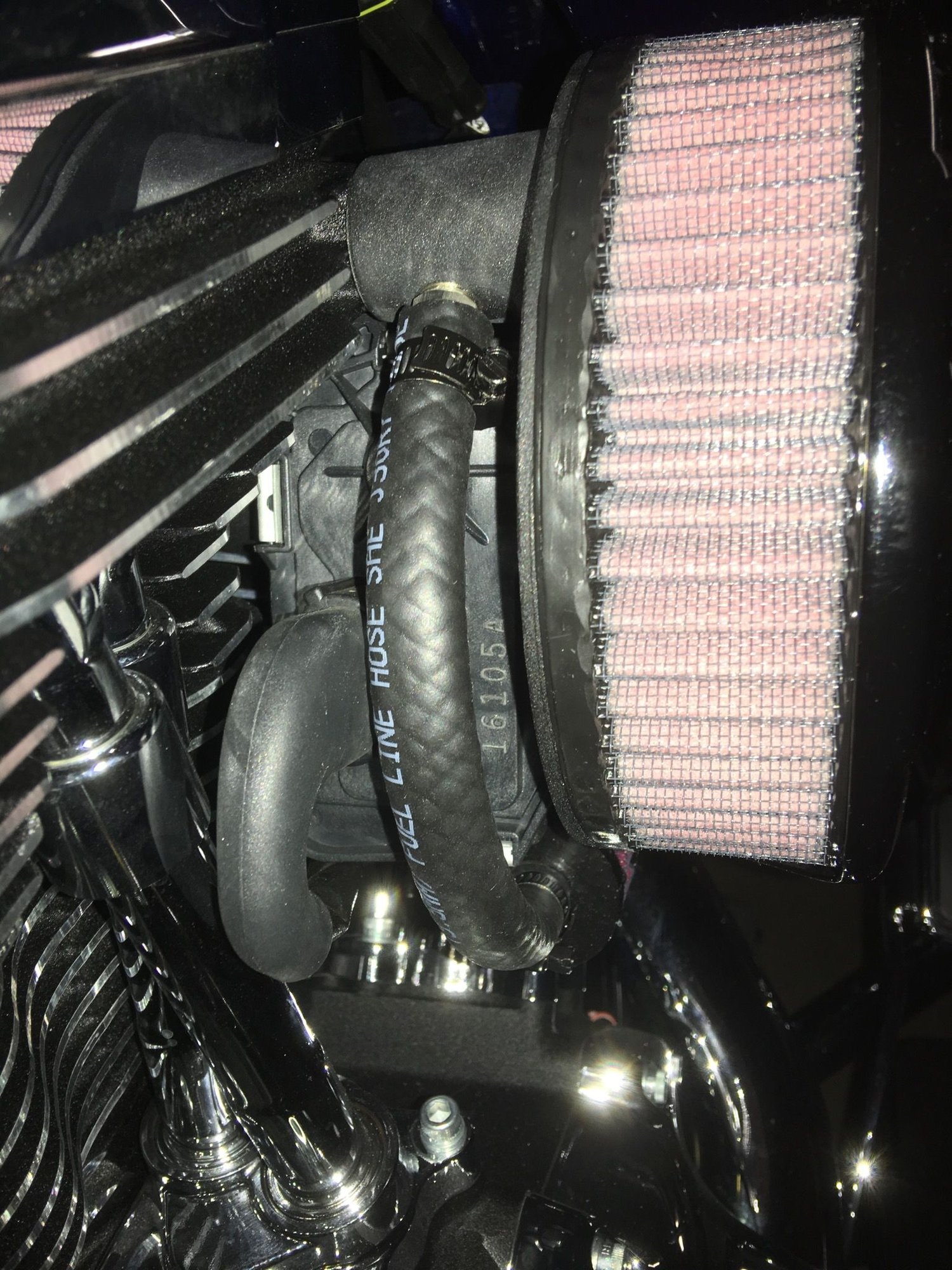

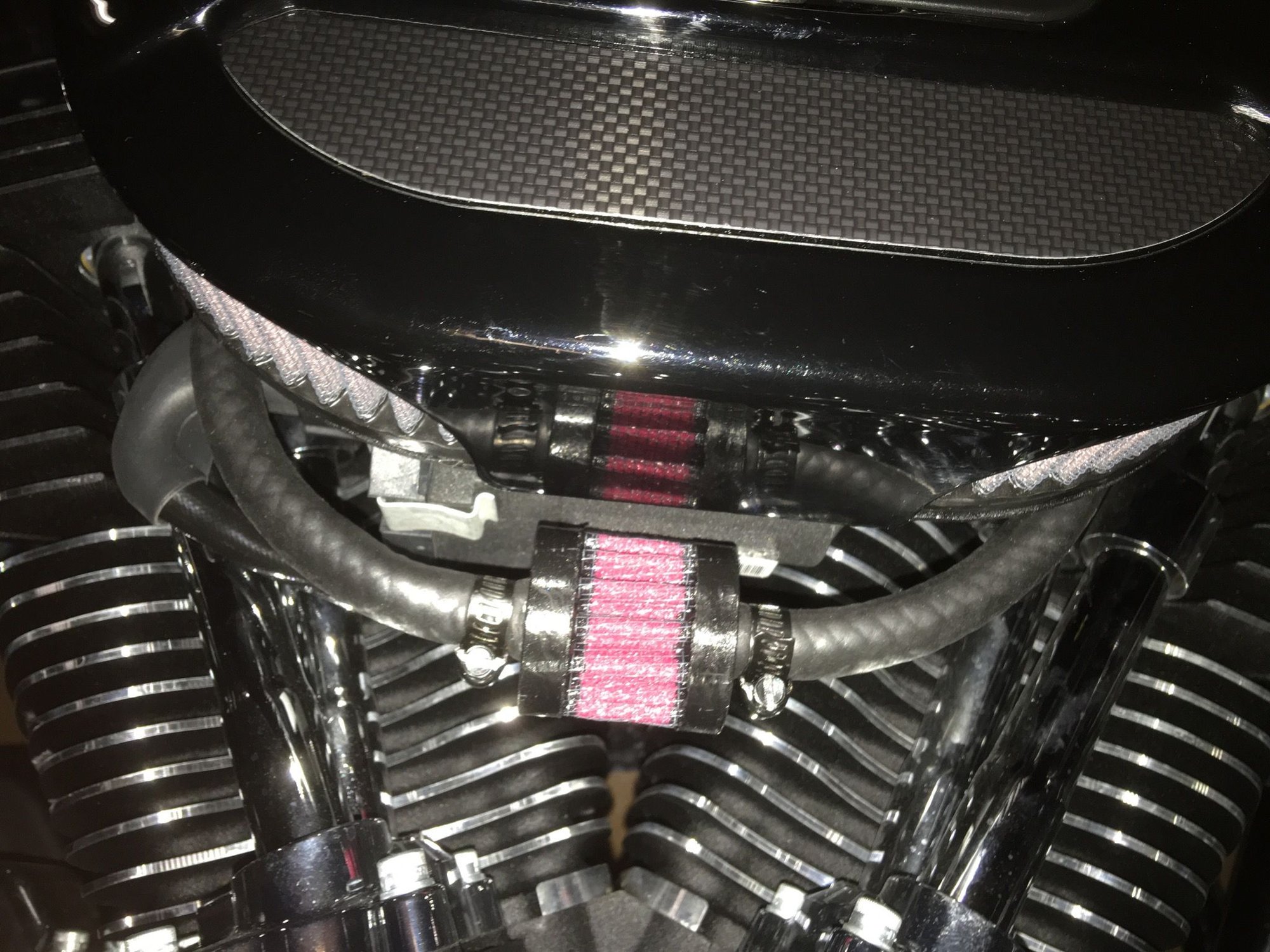

I picked up a cheap-o drill press from Amazon, which makes it really easy. That for the hose barbs to vent. I tap and fill the internal vent holes to the TB with a 6mm set screw secured with oil resistant red loctite. As an extra step i fill the same vent tube from the top side with JB weld injected through a curved syringe. Never liked the idea of any oil sitting on top of the set screws, oil resistant loctite or not...
Here's one I did to an Arlen Ness Big Sucker
And a HD Ventilator
Most recently did it to my Heavy Breather on my LR-S.

What size barbs are you using, drill bit and tap also ?
I used a zippers back plate and oem rushmore vent hoses to route mine. I am wanting to get a SE Heavy Breather and would like to vent it like yours.
Thanks
Old Nov 24, 2016 | 06:50 AM
Mchad's Avatar
Mchad
Joined: Dec 2014
Posts: 10,734
Likes: 3,755
From: SWFL
Thanks
I use 3/8" stainless barbs with 1/8" NPT threads, and a 1/8" NPT tap of course. To tap and plug the breather channels I use 6mm by 12mm long set screws and a 6mm X 1 tap.
The 1/8 NPT tap needs 11/32 bit, and the 6mm set screw needs a 5.2mm bit.
These are the parts I used:
Barbs
https://www.amazon.com/gp/product/B0...?ie=UTF8&psc=1
Set screws
Syringe to "inject" JB Weld
https://www.amazon.com/Syringe-Only-...Curved+syringe
And Loctite 263 (high strength - oil resistant)
https://www.amazon.com/Loctite-13305...ds=Loctite+263
All that stuff, some 3/8 fuel line for the vent, and last but not least something for the end...
Chrome
Black
That should cover it.
Some tips. Measure fifteen times! I ruined a backplate on my LR-S because I forgot about the TBW servo sticking out. You have to angle the barb to the back of the bike about 15-20 deg from vertical to clear it. No worries on the front.
Other then that, a drill press and a vice is highly recommended. Any questions, pm me. I've hijacked this thread enough! Sorry Silverado! (GREAT movie btw, if that's where it comes from)
Edit: to add, the breather channels that I tapped, don't need the drill press. A hand drill just to get the hole wide enough for the tap to grab, and you don't even need to if you muscle the tap in enough to grab. Just keep inward pressure for the first 1/4" or so.
