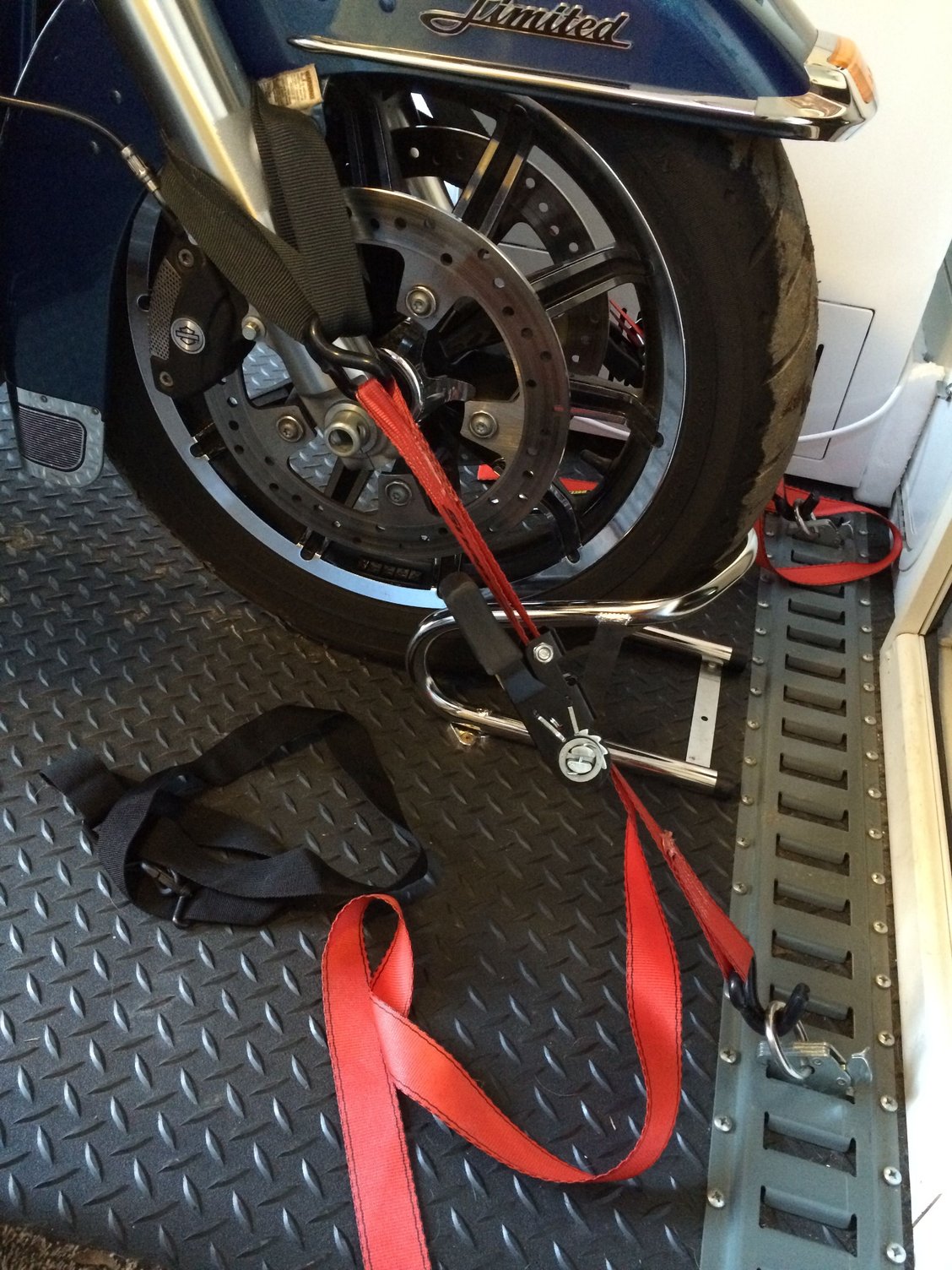

I do it this way. Many thousands of miles and it has never moved. Just strapped it in yesterday getting ready for a trip.
Ditto on this method, hauled my Street Glide 700 miles in the back of my brand new F350 when I road it to Dallas, Tx to buy my new truck. Never budged, and "Floated" on it's own suspension.

I use the around the downtube method on my Flhtc as a redundant and the bike never moves. I do put some microfiber cloths to protect the paint.

i just need help on where to grab the bike on the front. pics would be incredibly helpful.
i am thinking soft tie through frame and around engine guard, but looking for opinions.
wrap your strap around the fork tube right above where he fender meets. This will give a solid point and will allow the suspension to travel so you won't blow seals
Best way right there. Works perfectly every time.

I think I'd be worried about those hooks on the straps sliding out if the trailer started to bounce...maybe some kind of carabiner clip instead of the hooks?
I suppose anything is possible. . . I've never had any issue with that, though.
Cheap solution: http://www.etrailer.com/Accessories-.../CE16691A.html

Good option, thanks! Last time I wrapped electrical tape around the end of the hook, this looks neater and simpler, gonna order some!
