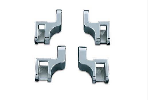

Have a 2014 ultra limited...
Looking to move footboards for comfort...
On certain forums I have seen kuryakyn do akit p/n 4588
Its supposed to move them 1 inch forward and 1 inch out...
But on kuryakyn website it does not list ultra limited...
Anyone have any ideas or used this???
Thanks in advance

I would imagine they will work. The footboard mounts are the same for all the touring line.
I have them on my bike. I like that they make the change at the top, instead of the frame. Moving hardparts out on a bike with limited ground clearance is a bad idea imo. That said, I have Tallboys lowering brackets as well - not so much out as down. But the added comfort is worth it to me.

I put these driver footboard extensions on my '15 Limited, fit just fine and the lowers did not effect installation. Have been very happy with them, never even noticed a loss of clearance after I put em on and I ride pretty aggressive.
http://www.kuryakyn.com/products/83/...ation-brackets
And the selection even lists the Ultra Limited.
