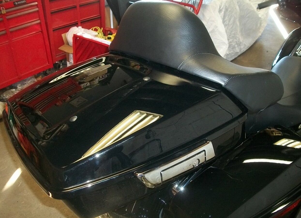

depends on what you need it for .. I just went through this
and decided that since mine wont be on the bike day in and day out
I would go the ebay route for the parts needed for mounting and the pack
itself.
you will need docking plates
http://www.ebay.com/itm/4-Point-Chro...5YnJpu&vxp=mtr
a mount
http://www.ebay.com/itm/Detachable-T...9XyZud&vxp=mtr
and a tourpak, I went with this exact chopped pak but from a USA seller though
none currently available that I could find this AM
http://www.ebay.com/itm/Chopped-Tour...JX0mZC&vxp=mtr
the tether that it comes with is garbage so I upgraded to the 14+ style BUt left
the one that comes with it for redundancy
http://www.ebay.com/itm/Tour-Pack-Li...5YsVVP&vxp=mtr
I spent $496.93 total and the vivid black matches the bike 100%
I did have trouble with the tourpak rack and am waiting for the sellers response
thought we had a fair solution but he is dragging his feet

Old Mar 18, 2017 | 06:04 AM
1HD1C's Avatar
1HD1C
Joined: Apr 2010
Posts: 3,428
Likes: 239
From: northeast
seems to be well made for the price
