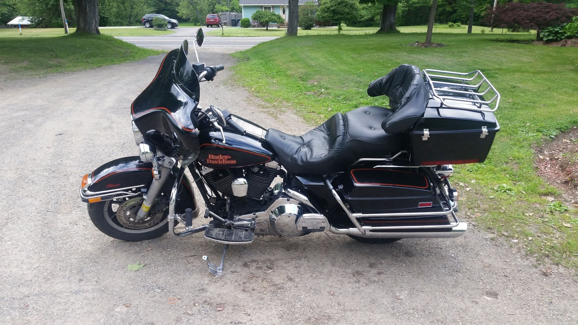

Got the seat the backrest the tour pack with luggage rack tour pack mount and grab bar for $50. I spray painted pack and wet sanded and buffed for hours you couldn't even tell it was painted. Total cost $90 to have a pack put on my 1990. Now I used a mount from a earlier model touring bike had to make modifications but works great looks factory.

Looks good. And a good deal, too.

Good find on the tour pak, great job on the install.

Damn that looks great , i need a deal like that keep your eyes open

Lol yeah I got lucky for sure. And I'll tell u what everyone that sees it can't believe it's spray painted lol.

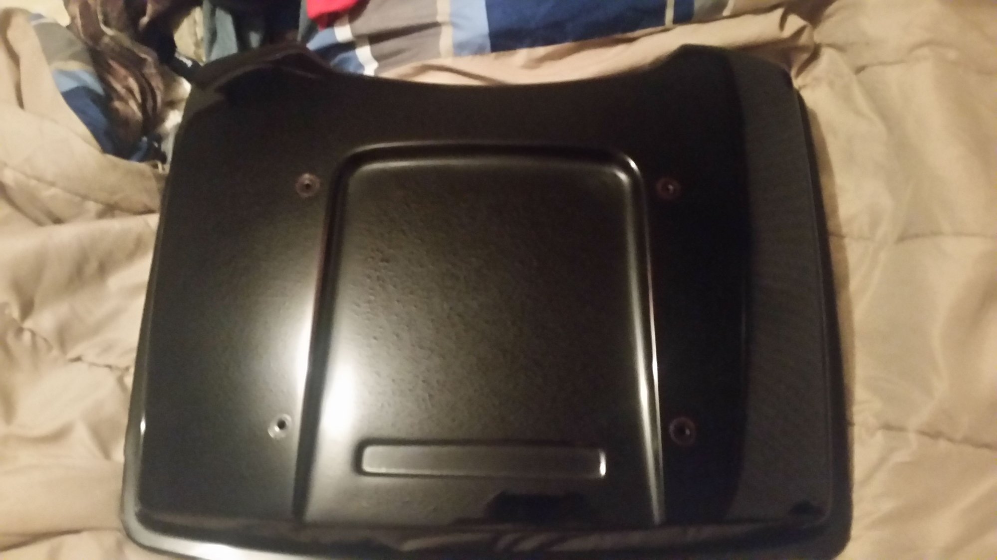

Old Jun 4, 2015 | 11:02 PM
crazydawgs's Avatar
crazydawgs
Joined: Feb 2015
Posts: 154
From: ny
This is the lid when I was done notice you can see the reflection of my ceiling in lid lol
