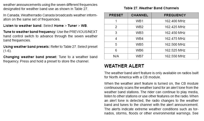

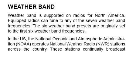

Getting the update installed tonight. And I am going to look in the manual for instructions on how to turn the WB off. Thanks a ton guys, i had been away for a few days and missed some very good tips.

Look no further:
