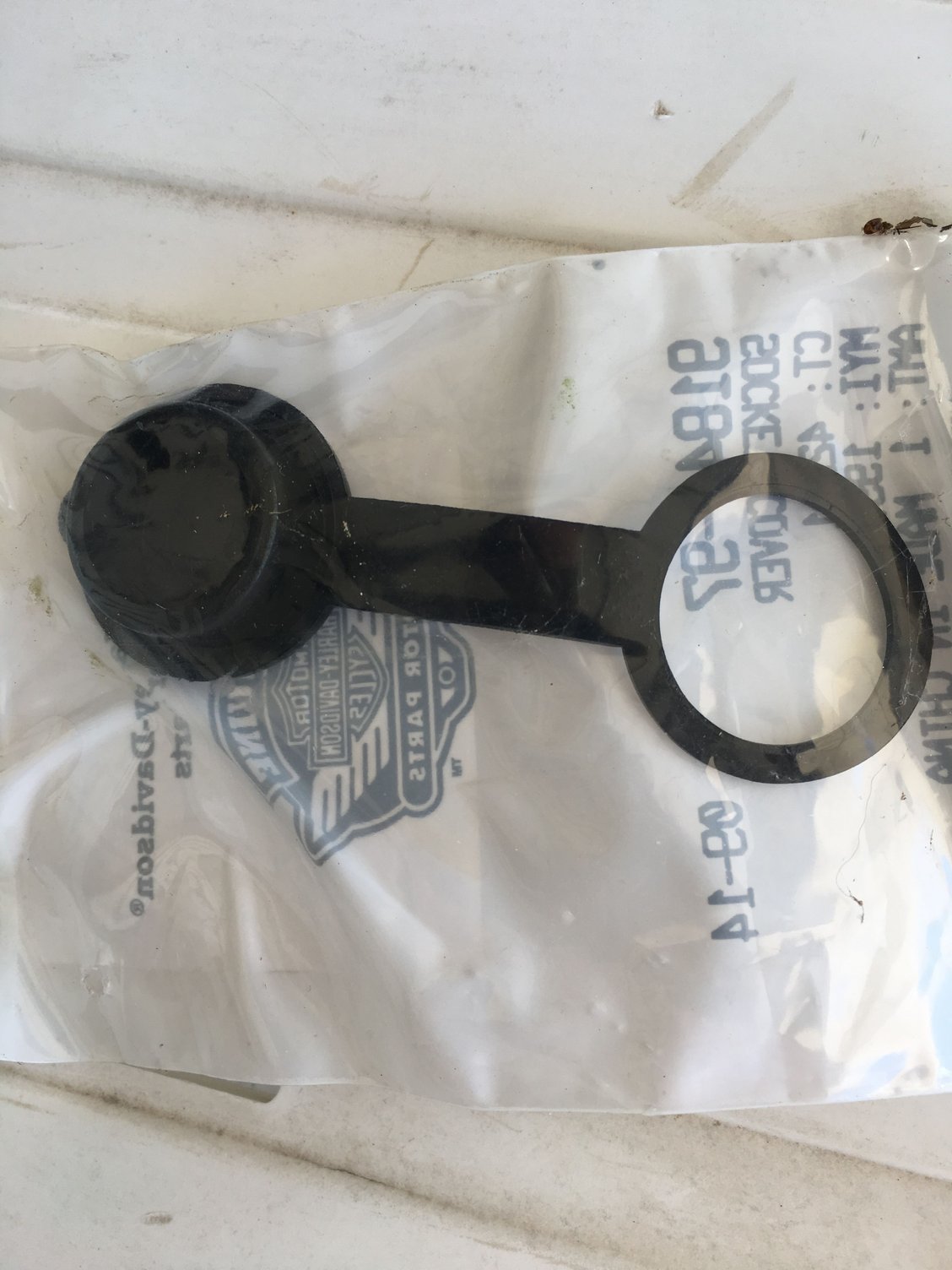

Order these covers. I'm going to tell you first the parts guy have never seen them. They are used on the Police bikes. It is made of soft rubber and makes a good seal to the fairing/outlet and the stopper. Order several and give to your friends, they are like $1.50 a piece and work great. H-D Cigarette Lighter Cover # 91844-97.

Originally Posted by K Melancon
Order these covers. I'm going to tell you first the parts guy have never seen them. They are used on the Police bikes. It is made of soft rubber and makes a good seal. Order several and give to your friends, they are like $1.50 a piece and work great. H-D Cigarette Lighter Cover # 91844-97.
That's pretty cool. It doesn't have a raised portion to grab onto?
