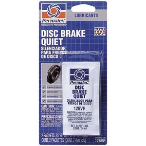

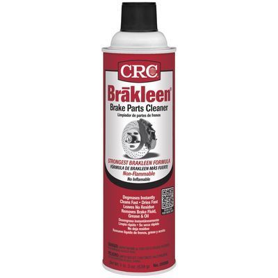

I really have had no issues with squealing brakes, glazed or warped rotors and I ride aggressively at times. The only occasions I've had a minor issue with sqealing is after riding in the rain, but after a couple of really hard brakings, the squealing is gone. This is what I do:
Put a thin film of this on the back of the rear pads.
Clean the rotors with this. Don't let it get on the pads.
