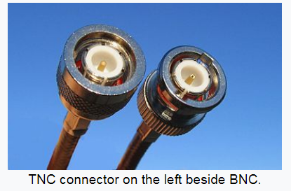

Originally Posted by Hammz
The coax connector on the CB is a female TNC bulkhead connector. The coax itself requires a male TNC connector.
As IH said, it's similar to a male BNC connector that has threads as opposed to a bayonet style retaining feature.

I've considered replacing the entire cable from the radio to antenna, but I'm having problems finding the male TNC. Anyone have a source? Maybe with it pre-installed on the coax?
https://fieldcomponents.com/
I just went to the local commercial radio place and they were absolutely happy to custom make me the coax cable complete with connectors, in 5 minutes, for less than $15.
