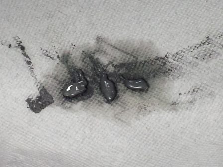

Originally Posted by Hammz
Let me throw this in: At 25kmi service there was a leak noticed on the right side fork tube, so the tech pulled them figuring new seals were needed. The lowers were shot & needed to be replaced (done under ESP) w/new lowers. By "shot" I mean there were areas of excessive wear that prevented a good rebuild. I'm guessing the failure was due to improper cleaning or prep when the lowers were removed & sent out for powder coating before I took delivery when I purchased the bike new? IDK? If any case, the original lowers did wear out & got replaced under ESP.

Also, your comments regarding seals & bushings are irrelevant; I had/have cartridge front suspension. Also, springs DO NOT "handle the rebound."
This is a pic of the crap that came out of the right fork lower. Mostly aluminum scrubbed off the inside of that fork lower by the bushings.
