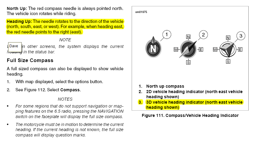

What software version are you running? Older software, the "compass" isn't a compass, it's a direction of travel indicator. Here's an excerpt from the 2015 manual.

1.21.2.1 and I have it always set to 2D & heading up. I refer to it as a compass but you are correct, it is a heading indicator. As I said, it indicates I am heading E when I am actually heading W.
In the above graphic, my actual compass is showing NW but the heading indicator shows NE.
edit: Shouldn't all the directions match? For example, if the compass screen shows I am heading South and the bottom of my music screen has an "S", shouldn't the heading indicator on the map screen point to the south?

If the map is oriented to "direction of travel up" and the direction of travel is west, a compass will point to the right (north) & a direction of travel indicator will point to the left (west, as north is always up for the direction of travel indicator).
