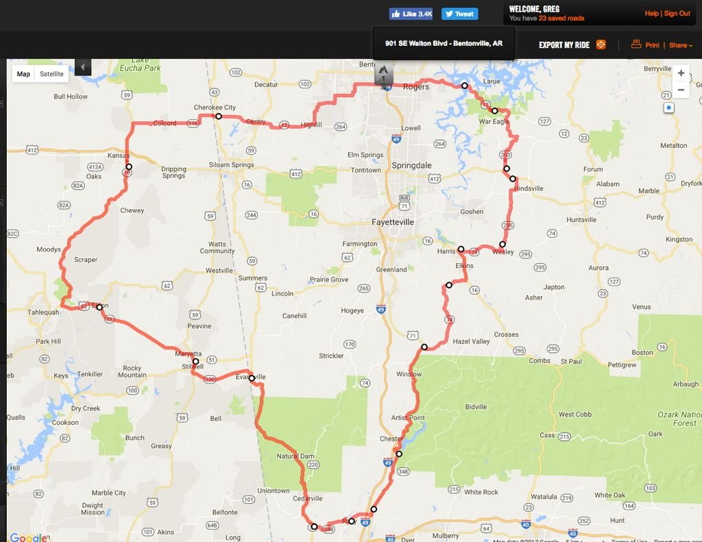

OK, since we are discussing the HD Nav unit and HD ride planning software, I can make any custom route I want, and it will follow it exactly as I planned.
Here is a ride I planned using HD Ride Planner for last years trip to Northwest Arkansas.
Starting at our Hotel in Bentonville, Arkansas
I placed waypoints along the way, so the ride used the exact roads I planned.
And ending back at our hotel.
17 toal way points.
228 miles (5 hr 10 min ride) - One continuous ride start to finish.
The HD Nav unit followed this route exactly as planned.

That works if you have it set for faster time or shortest distance between waypoints. Let's use the waypoint at the intersection of 74 an 71 near Hazel Valley and the next (assuming a clockwise route) waypoint just below Chester. If you have the preferences set on Twisty the system might guide you to turn left at Winslow and follow that twisty road through the Ozark National Forest down to Artist Point. The only way to insure that doesn't happen is to have another waypoint between Winslow and Artist point. The Ride Planner software won't show that route, it'll show what you posted, but the GPS unit on your bike may calculate otherwise based on the Preferences and Avoidances you have set.

I will agree with that.
But as I mentioned, every GPS unit out there works the same way.
My point is, you can create routes in HD Ride Planner (or any other mapping software), and have your GPS unit (HD Nav, Garmin, TomTom, etc.) follow that route exactly.
The key is learning how to use the tools you are using.
Note: I have my GPS unit set on fastest, and the only avoidance I have is unpaved roads.
That makes it easy to plan routes using web based mapping, and then use strategic waypoints along the way to ensure your GPS unit follows that route.

Those are the same settings I use and the routes I plan look similar to yours (Except I'd probably have turned left at Winslow....).
You understand how to use the tool you have, not everyone with same tool does. I'm hoping to include them in the discussion.

Humm .. maybe the little white dots opposed to the gray boxes ... that could be my issue. Im going to play some more.

I was traveling South to North at that time.
We were riding counter-clockwise looking at that map.

When your route starts and ends at same location, do you still have to put in an ending location or will the route just end itself at start point? I don't see 2 location points at the above map, unless they are stacked on each other.

There are actually 2 location points on that map, but it isn't zoomed in far enough to see them both.
