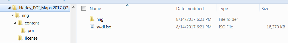

I'm using a PC windows 10. I've tried 2 different jump drive 1 was brand new. I unzipped both files to drives. I had done this before and never had problems. How can I get it to go back to normal screen? I had read that we were have trouble with it working with new update. Ive tried to reset with key off hold down power button then turn on and have pulled maxi fuse. Any other suggestions?
With the drive out turn on key after a few sec sez to insert drive to finish up date. I do that and I let it set for 3 hours and still it cycles between black screen and the please wait.

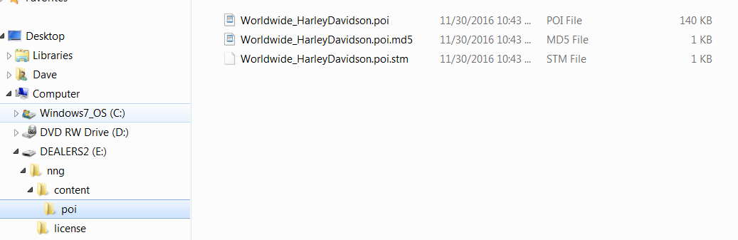

You may not have what you need on your USB? You need the ISO file & the NNG FOLDER with ALL its' contents on your USB drive.

I have the folder and the .iso file like you show. How can I get it out of this loop so I can revert to older radio update then install new dealer then new radio?
