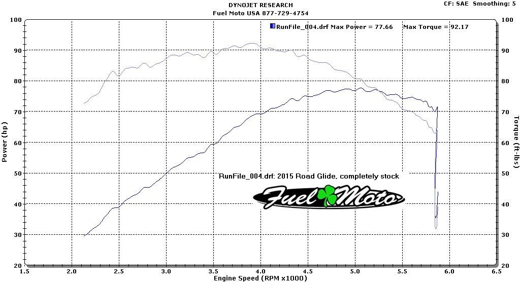

Originally Posted by White Glide
Thank you so much for your input and the graph of power results.
Looks like the 255 is making similar power as a stock 103HO. The 255 S are great cams and would be an upgrade prerushmore bikes but to similar on a rushmore bike. The cyclerama or woods would be an upgrade IMHO.

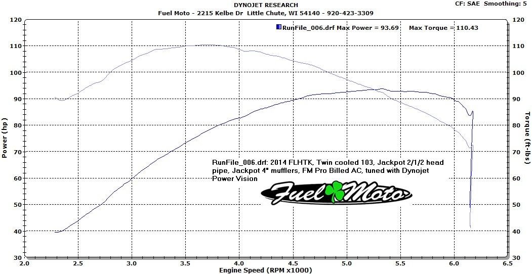

Originally Posted by Bafflingbs
Here's what you can expect with your combo, if you decide on the woods... And Cyclerama's are even better. They come on earlier and carry out longer, with higher numbers
Here is my concern, Fuel Moto gets just as much power with a stock cam on this set-up. I guess it is, all in which head pipe one runs.

Different bike. Different day. Different operator. Different heat and humidity... comparing overall numbers is pretty useless. Also they are in the buisness of selling their own exhaust.
