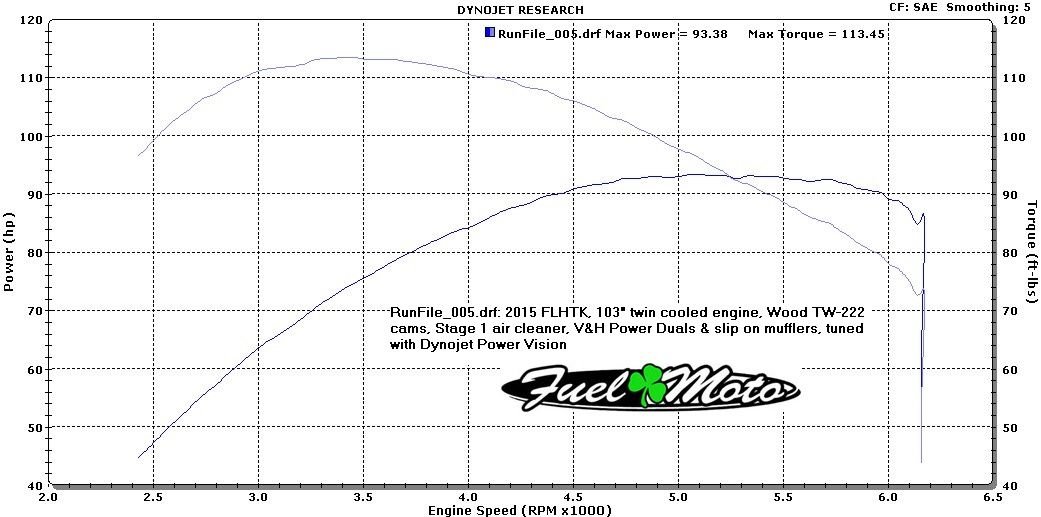

Old Feb 18, 2018 | 07:43 PM
Bafflingbs's Avatar
Bafflingbs
Joined: Jul 2015
Posts: 2,659
Likes: 925
From: Maryland
Here's what you can expect with your combo, if you decide on the woods... And Cyclerama's are even better. They come on earlier and carry out longer, with higher numbers
