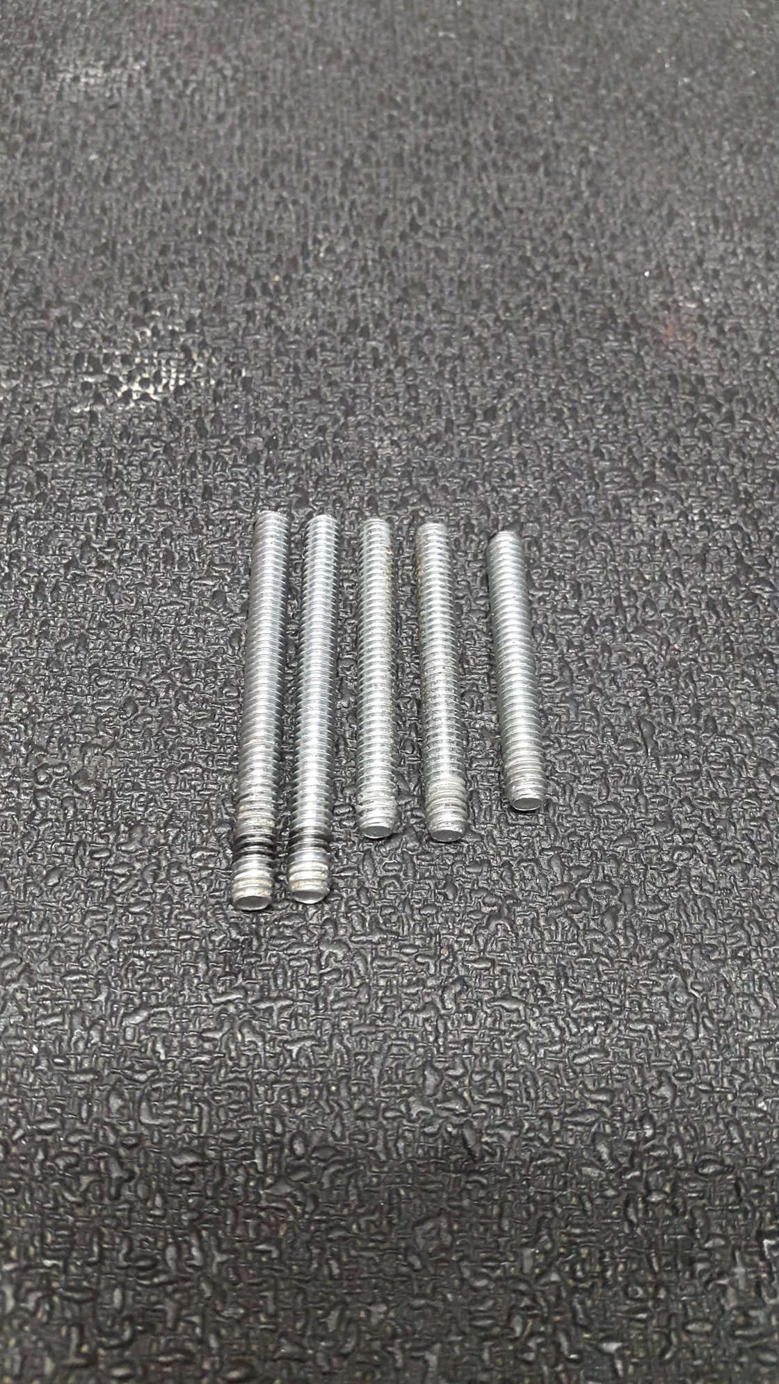

Traildog should you decide to pull the outer primary cover I'll give you a tip I use. I have several old long primary bolts with the heads cut off and the ends cleaned up (not the part that threads in). I screw them in by hand on the inner primary in a couple different places before I re-install the gasket. I hang the gasket on the locating dowels and the headless bolts. It makes putting the outer cover on easier without having the gasket fall out of place. Once I get a couple of the regular primary bolts in, I remove the longer ones by hand and replace them with the rest of the bolts. I torque everything down in sequence and am good to go.
