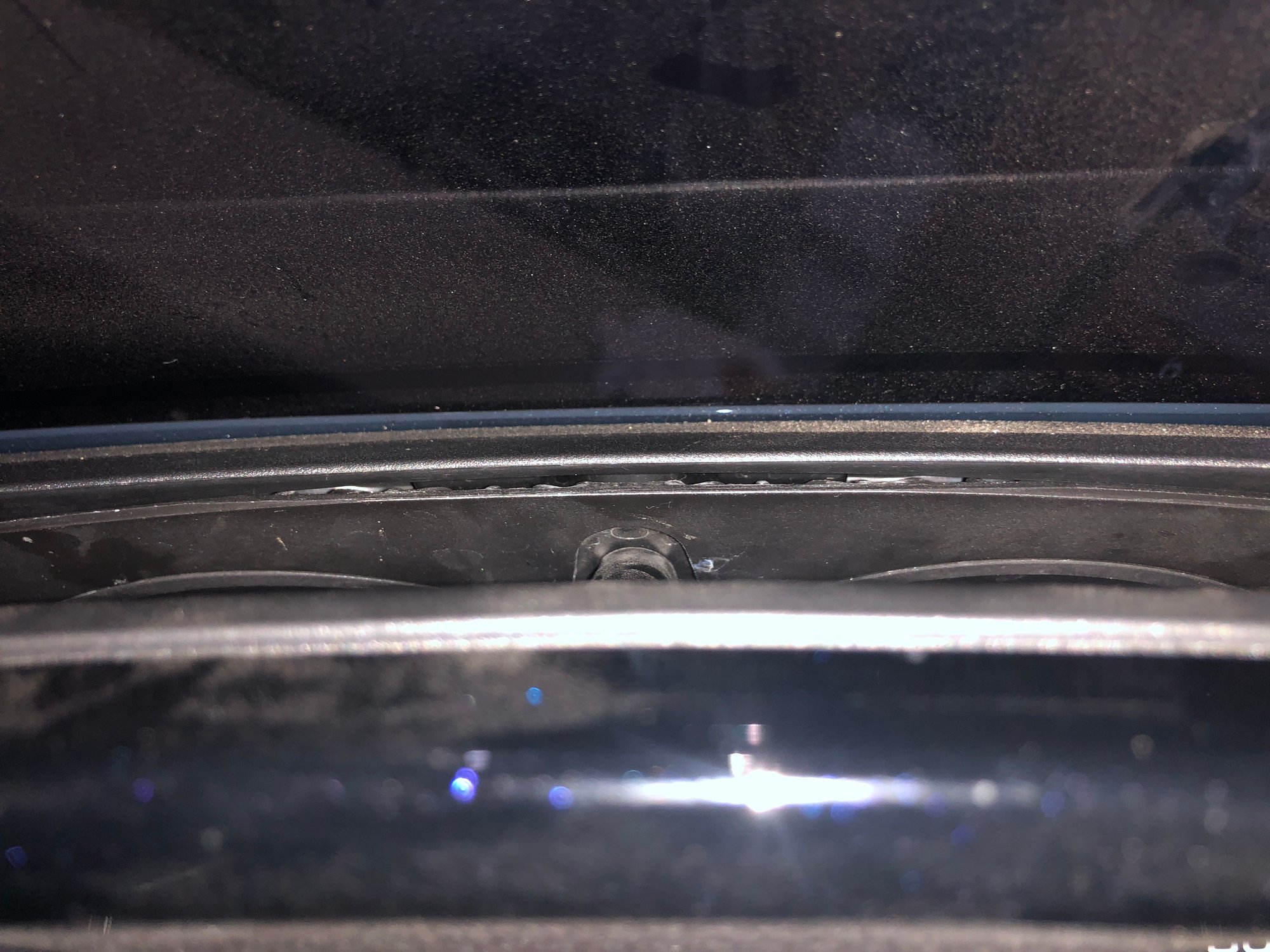

I'm getting whistling from the vent on my Street Glide. The source appears to be the vent does not open completely creating a small gap for wind to move through. I can push it open with my fingers but it doesn't stay in place. Anyone ever have this or know a way to fix it? Of course it would happen the first month the bike is out of warranty...

Yep, did a search and the majority of whistling issues seem to be from the RG. I’ve been able to isolate it and stop it by holding the vent all the way open. Wish I could take a better picture of it, but this is the gap at the top of the vent when open. It’s the plastic inside that rotates to open/close.

I have the exact same thing happening on my 2018 FLHTK. Bike is only a couple of months old. I taped the vent open and that stopped the whistle.
I will be taking it back to the dealer to see what they say.

So just to update. I did go to my dealer.
No questions asked. They have a new vent on order and will install it under warranty.
Kind of surprised. No hassle no nothing.
