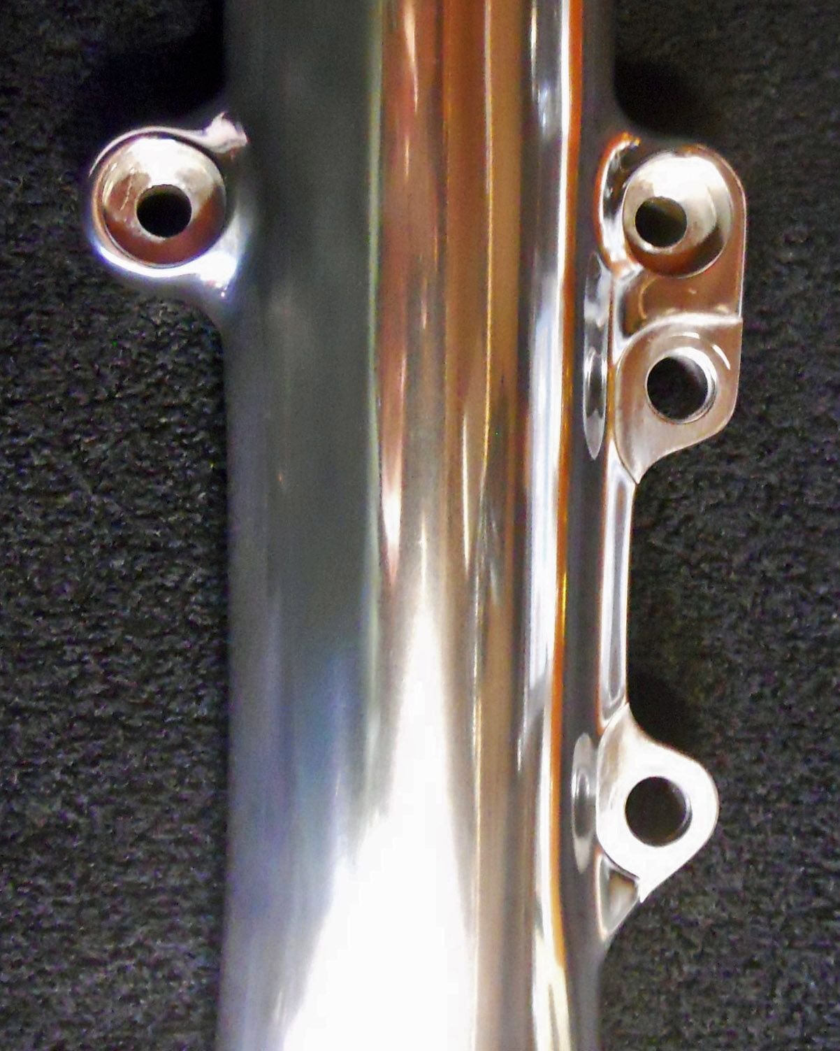

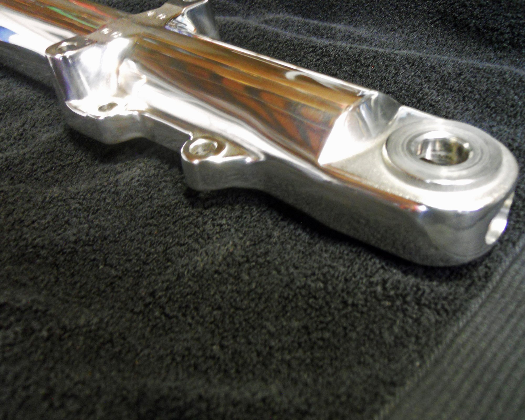

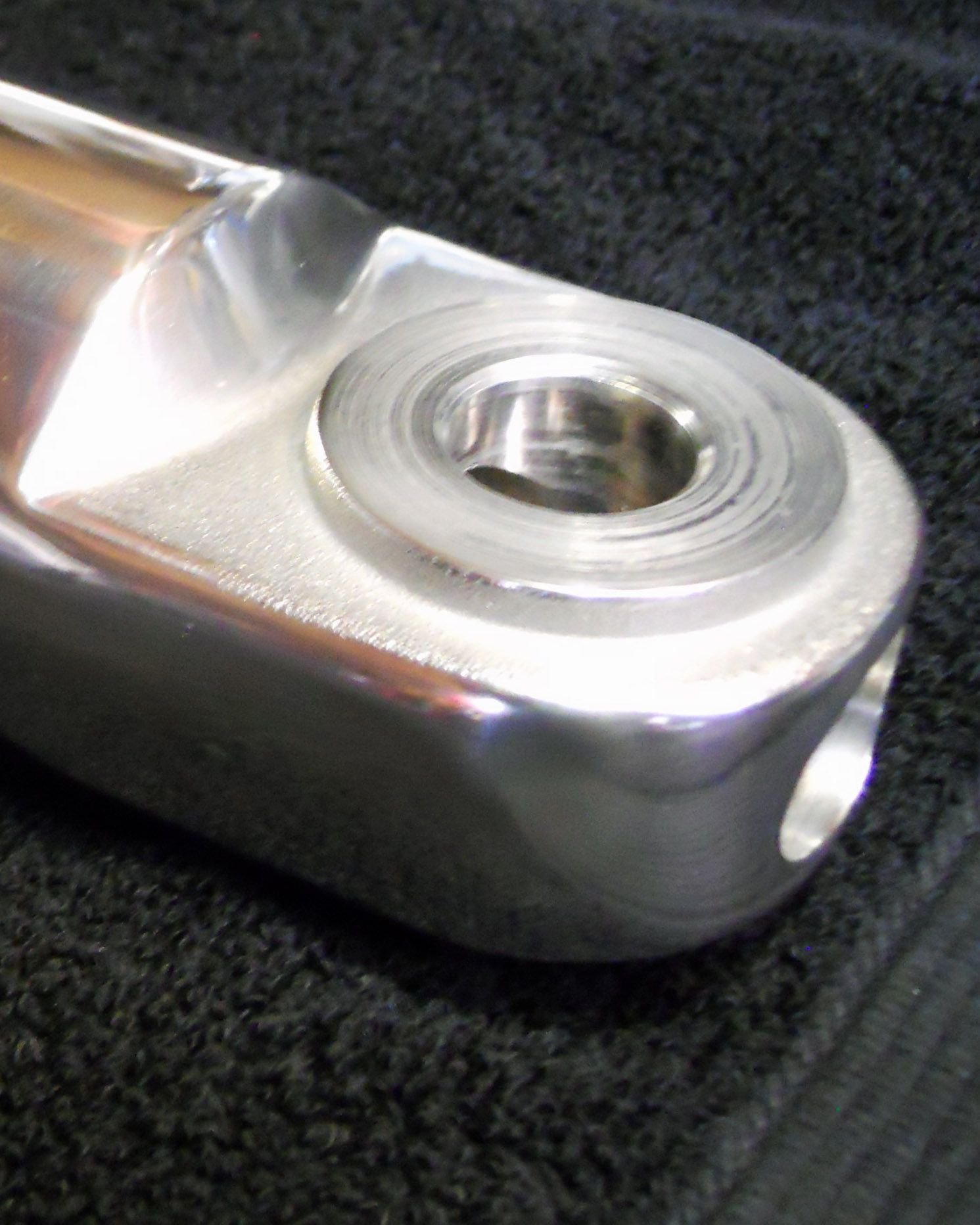

That's pretty much what I did. I bought a set of take-off's from eBay (Cheap!). Sanding with finer and finer grit and then polishing.
My cost included new seal kits and new fork oil in addition to the forks I got on eBay.
Any damage is easily taken care of with some wet-or-dry sandpaper and a bit of polish.
Here are some pictures that I took before installation.

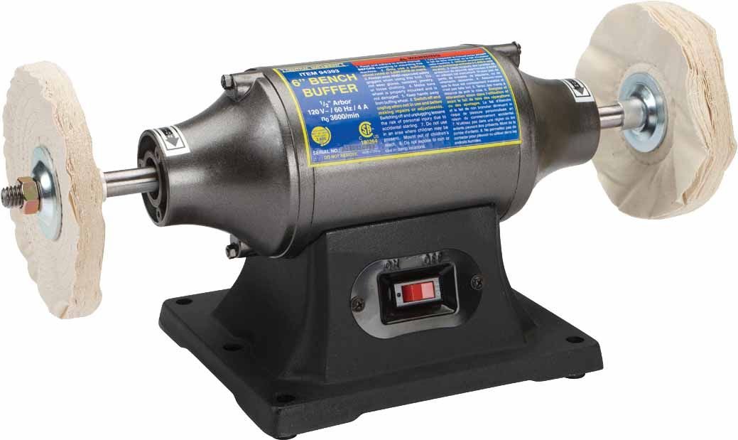

Mostly by hand. It took awhile. The hard parts are the tight curved areas around the fender bolt hole mounts and the brake caliper brackets. I did use a bench mounted buffing wheel (Harbor Freight -see below- $42 after using one of their 20% discount coupons) for the final polishing after the 2000 grit sand paper. From beginning to end in sandpaper grits: 120, 320, 400, 600, 800, 1,000, 1200, 1500 and 2000.
