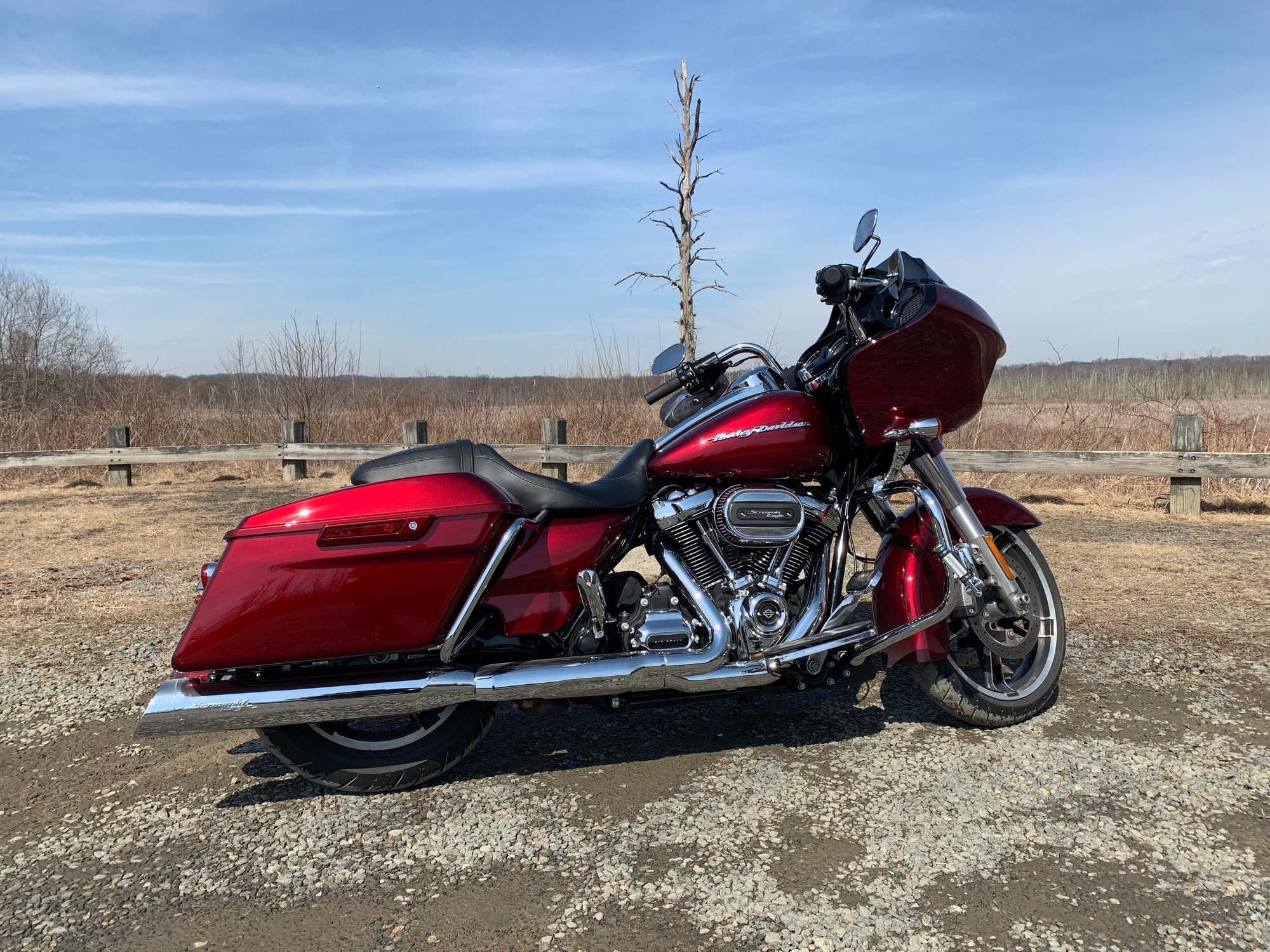

Originally Posted by cptdenny
... With the latest software update (1.22.02) my GPS audio has been working 100% since I’ve had it downloaded 2 weeks ago.
I hope the GPS bugs are all gone.
Not so for me.
I went for my first real ride today, since the first week of January (It was clear and the temperature ranged from 55° to 59° in NJ while I was out.. I was in heaven).
But the prompts cut out the same way they usually, or at least most often, do for me. I stopped to take a picture while in the middle of a "trip" loaded from GPX file on USB. When I started the bike back up, The nav. systems resumes my trip perfectly (e.g., between the 4th and 5th waypoints) but no prompts. I turned the bike off again 15 minutes later, but this time (now between the 6th and 7th waypoints) the prompts are back. I never adjusted my "prompt volume" during the ride; it was correct the whole time.
Here's the picture.
