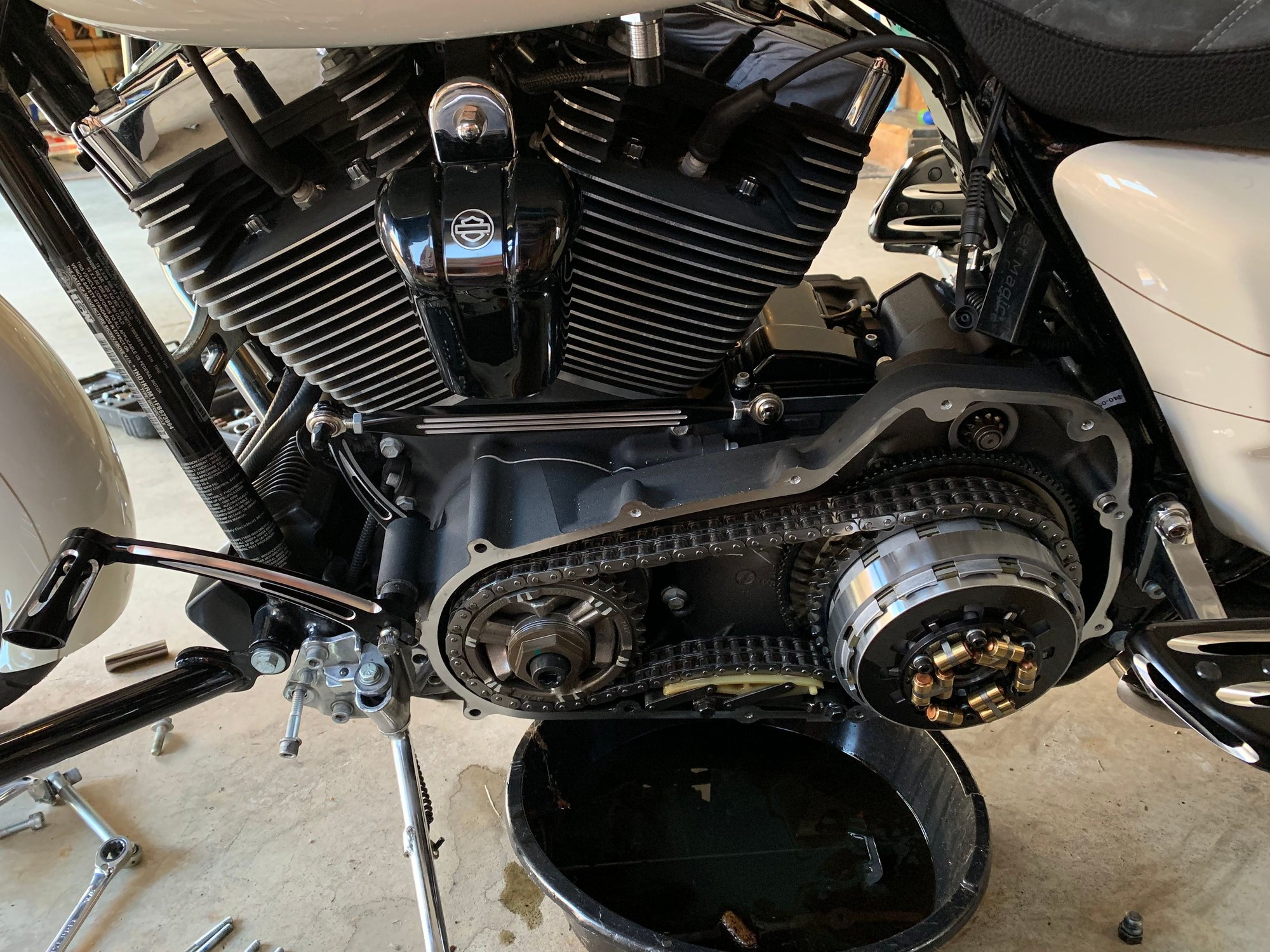

Mine was slipping a bit too. Once I put this on, it never did again. Plus, it decreased the lever pull resistance by at least 40%

Very easy to put on. This is mine. You do not need to pull the primary cover to install this. I have mine off because I blacked out my engine.
