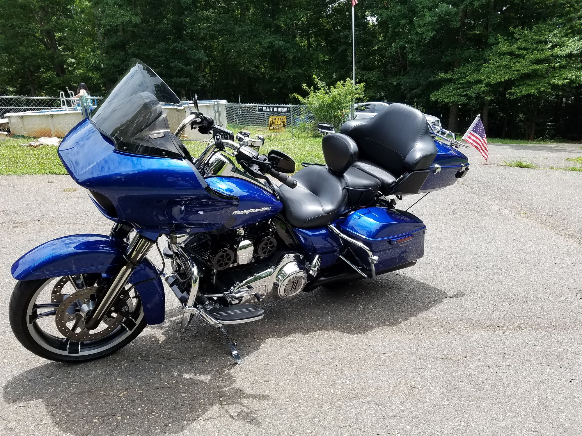

I thought I had the dreaded bad compensator on my 15 RGS so I pulled the primary to check it out at about 2000 miles. It was just that the primary so noisy as hell with that HD primary chain adjuster. So I installed a hydraulic one from Southern Oregon Hot Bikes. I had one on my older RG with a 120 motor and never had an issue. After the install, the primary has been quiet as can be. Really happy with this. Thought I would try out the Baker Attitude adjuster and see how it works and as soon as I got it in and running, my primary went back to sounding like marbles rattling around. Figure that one out. Compensator and clutch basket are tight. Never seen something like this happen. Just turned 30K miles a couple of weeks ago and the SOHO hydraulic adjuster is still working great. May be of use to some of you guys having issues with the HD adjuster putting all that pressure on the primary drive.
