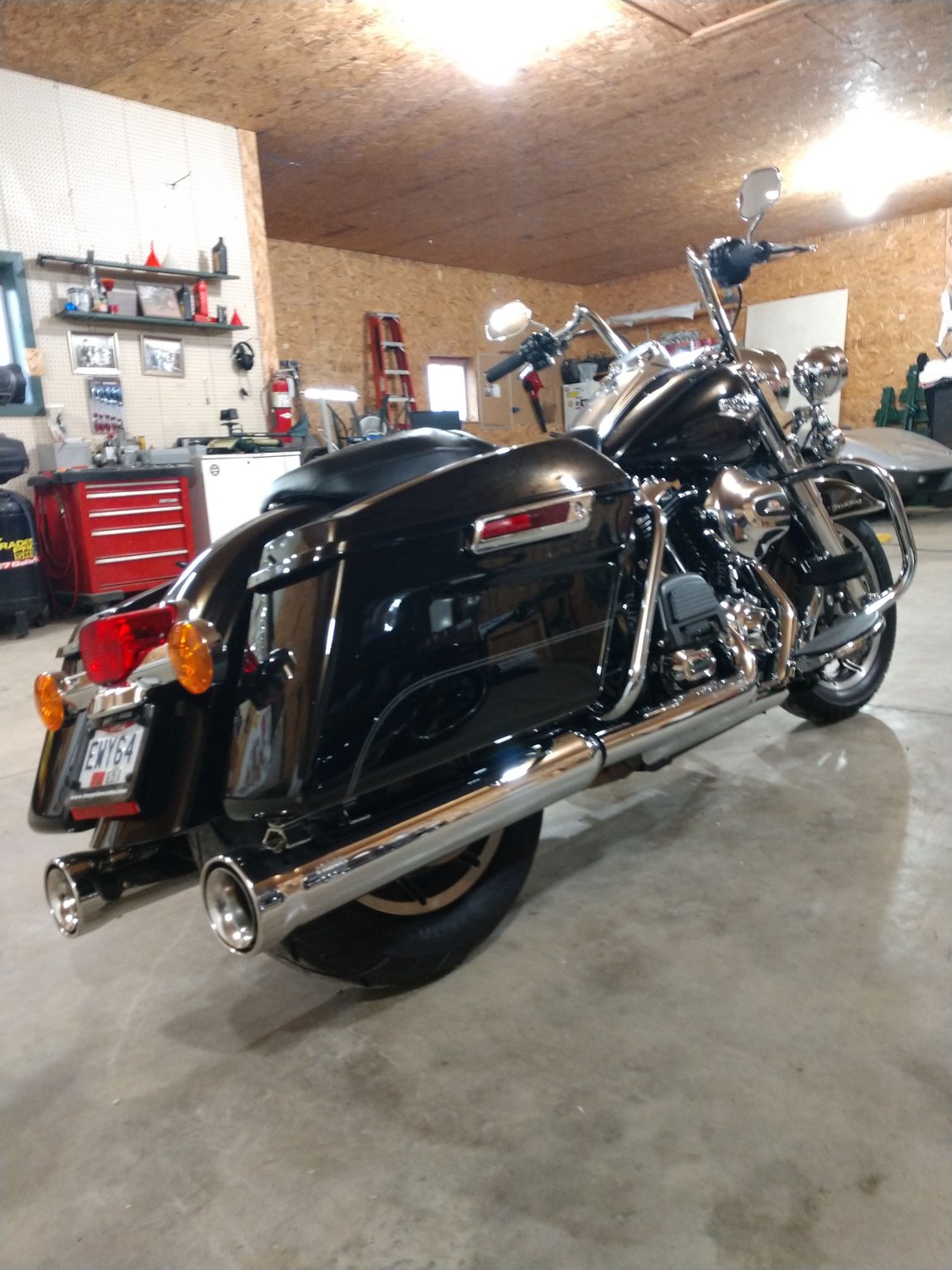

Bet your bike is gonna SCREAM! IIRC, you got a black RoadKing?

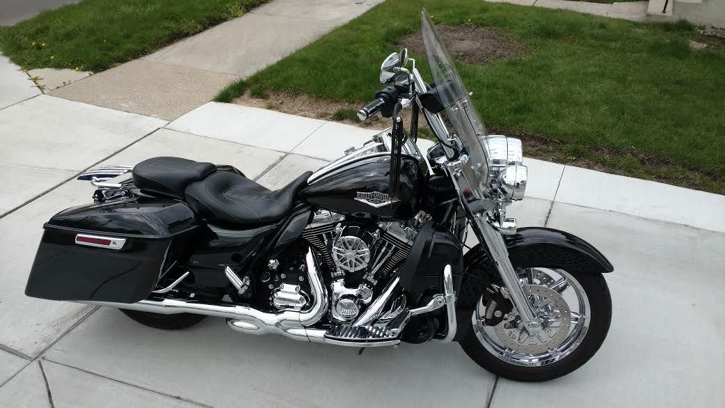

It's Starlight Black Metallic, I sprayed it with rattlecans.

Magnut, friggin gorgeous! I'm chasing the look too!

You got a good start, love the apes
Very tastefully done sir.....looks beautiful !
