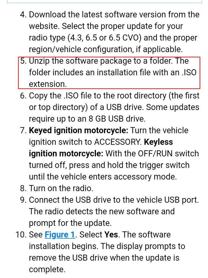

I've done every update as they came out. For some reason they never tell you in the instructions you must unzip the file on your computer before you copy the file on to the USB stick. I don't know why they would assume everyone would know to do that.
That information is in the manual that came with my 2018. It's not in yours?
The instructions on the H-D website don't specifically say "unzip", but they do say copy the file within the zipped folder to the USB flash drive. I mean, unless you're just a total computer illiterate, you'd have to know to unzip the file first, wouldn't you?
