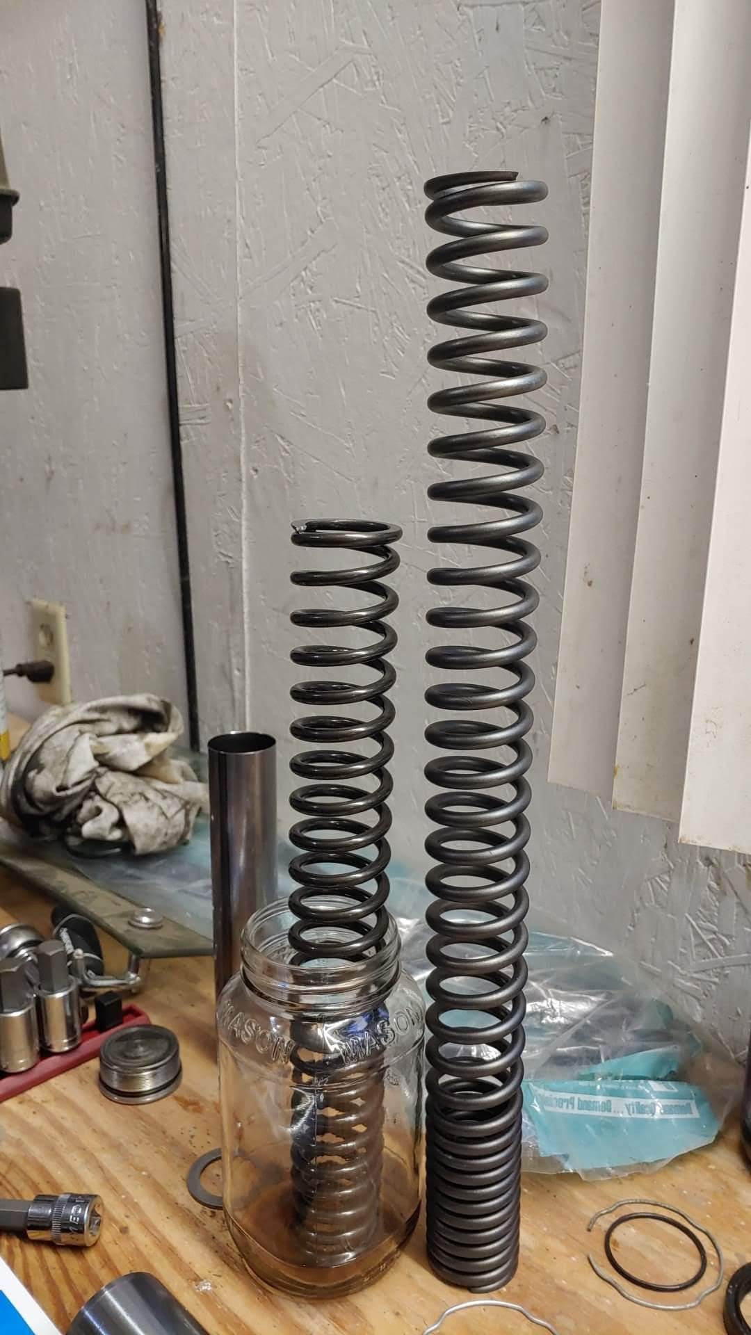

All I installed the stock height Progressive fork springs on the 2014 Road King. I have stock oil weight and cut the spacer to 2.62 which is what Progressive has on the sheet. Now the front end wants to follow every grove in the road and if I'm leaned over in a curve and hit a bump man watch out the entire front end shakes. I know weighing only 180 lbs and riding solo 98% of the time makes it so I don't have very much front end sag. These are also so stiff that the handle bars shake like a springer front. I have put over 1200 miles on them since the install and no change. I have included a pic I took comparing the stock spring to the progressive, much more spring than I expected.
