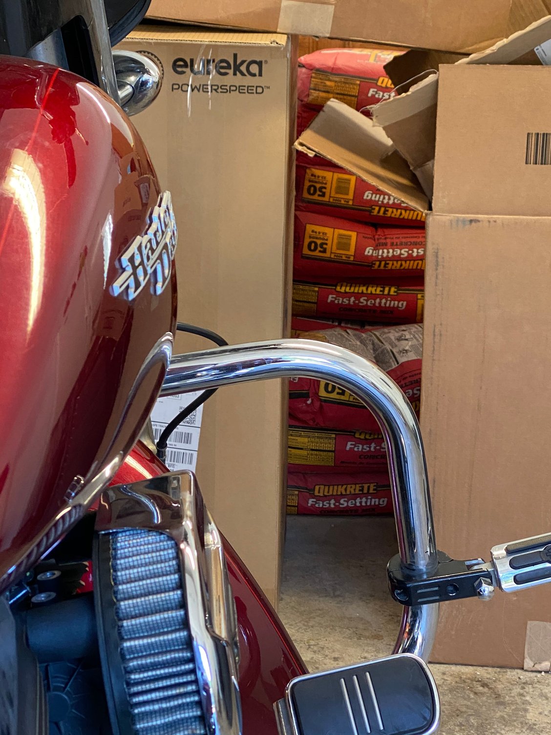

Old Jul 14, 2020 | 09:17 PM
dmonger's Avatar
dmonger
Joined: Feb 2019
Posts: 832
Likes: 219
From: The Shit Show
Just realized I quoted the wrong poster... but for reference you can see the ventilator barely extends past my tank.
