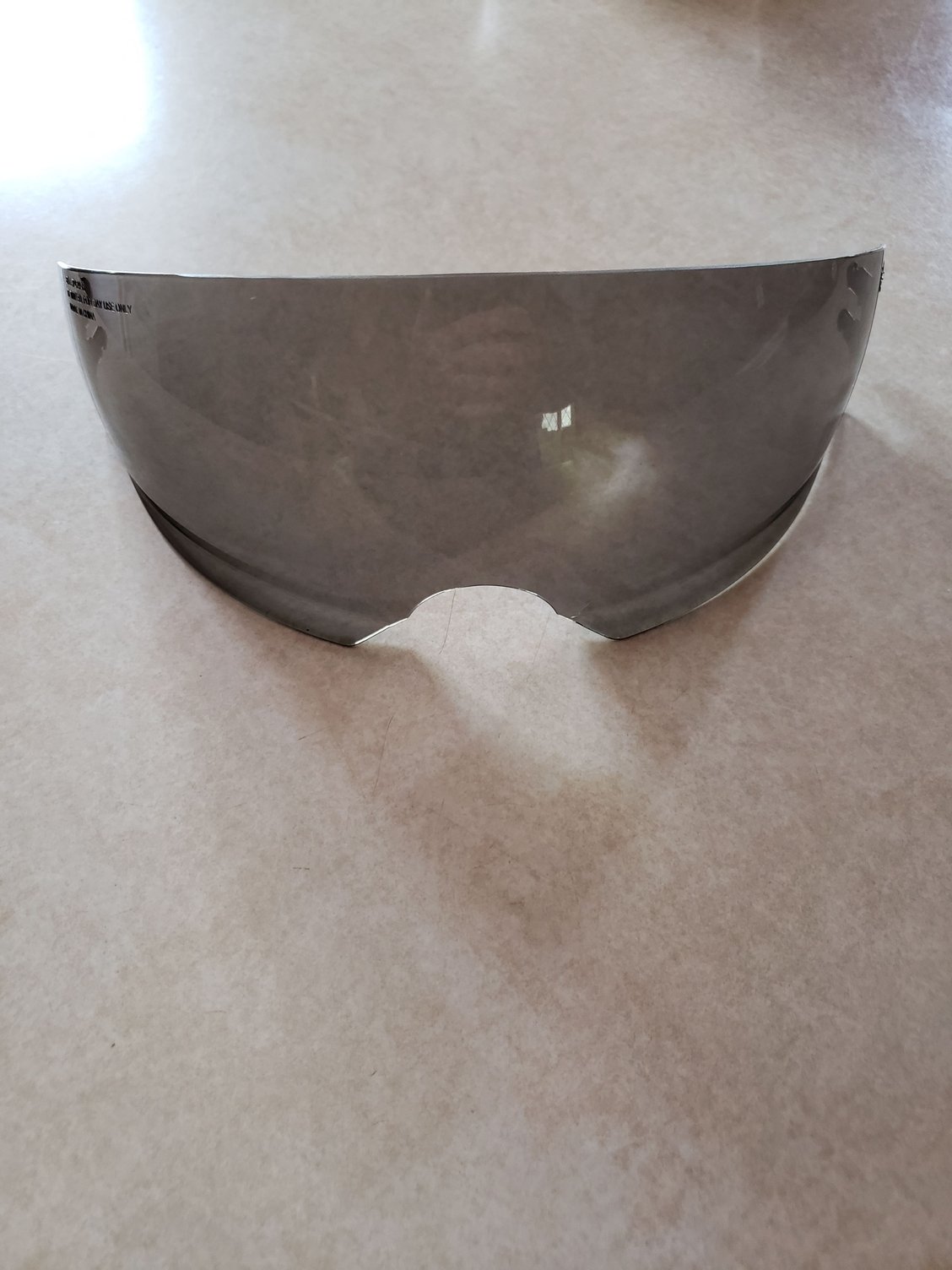

Default Found the problem
Found the source of the noise in my Bell SRT Modular helmet. It was the sun shade that was rattling around inside the shell. I pulled it out and rode with it yesterday, and it was quiet like I expected it to be. Now I will have to determine whether it was installed incorrectly or if it is defective.
