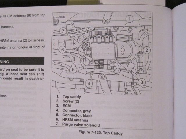

12.6 VDC is a little on the low side , 13.4 ~ 13.6 is more common for a healthy battery , that said it doesn't seem significant enough to be the issue. I would try re-seating your HFSM ( FOB / Security module) antenna connector under your seat , do you have the optional siren ? If so the battery for the siren may need to be replaced since it's connected to the security module . Image from 2014 Touring service manual . . . .
Thank you for the pic! I replaced the security antenna. Is there info on how to reset it? I have not been able to find any.
