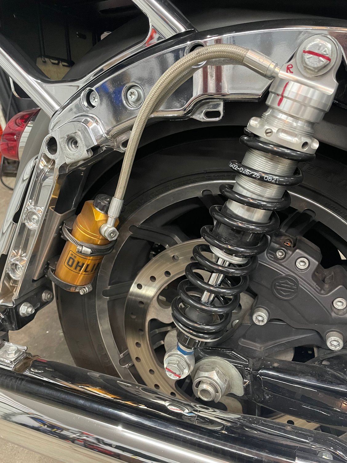

If Ohlins will sell you a set of HD357 resevoir mounting hardware you can mount the rezzies behind the bags.
I too don’t like the look of them hanging out.

I don't care for the reservoirs showing. The Ohlins HD044 shocks come with a very nice billet clamp, and a bracket to mount them hidden, inside on the bag bracket. No hose clamps involved
@lefty33
Thanks NW, good to know. I don’t care for the look of the hose clamps. However, about 40K plus later and my second bagger with these shocks… I don’t worry about it anymore…out of sight, out of mind. Anytime I take the bags off (frequent to adjust sag for 2 Up) I take a look to make sure the rezzies are snug…and they are.
Lefty…you may have a better way once you get your shocks buddy…may not have to go the HD357 mount route.

Oh, it was no slight on what you have going on, I was just posting what they have on the latest set
