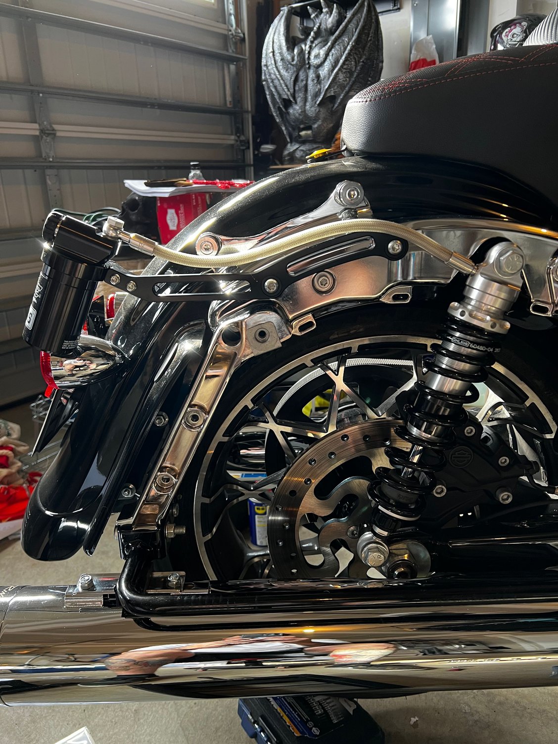

Last year, I bought a 2022 RG 107. I was coming off of a 2013 Dyna Switchback with Racetech GoldValve Emulators and springs, with Hagon 13" Nitro shocks with adjustable preload and rebound. My wife also has a 2013 Switchback with Bitubo Twin Adjustables.
Especially, after the test, I knew going into this bike purchase, suspension was at the top of the list for mods. For the front, I went with Traxxion's AR-25 fork kit. For the price of $499 at that time (their kit includes 2 qts of fork oil as well), the performance is very good. There is still a touch of sting in the front on hard hits, but I think that's also related to the 19" front rims. Quick sidebar, a couple of weeks ago, my buddy and I went riding and swapped bikes for most of the ride. He has just bought a totally stock 2017 RK, and I was shocked how much of plushness difference the RK's 17" front and 16" rear rims make.
For shocks, I originally wanted the Ohlins HD 044's, but couldn't take the hit of $1,500. I considered the Bitubo's that my wife has on her bike, but started reading about RWD's. The 4" of travel, remote rez, a few click adjustment for 2up...I was sold. As you had mentioned, anything is better than stock, and the RWD's are a very nice upgrade. However, I always had a "sting" in the ride, and had literally gone through every combination of the 2 clickers in search of a great balance of plushness and sport. Initially set the sag at 1" (per instructions), and also tried 3/4" and 1/2". 3/4" was best for 2up. Also, for 2up, I found the claim of not having to adjust for preload not to be true. Again, this is not to disparage the shocks as they are a worthy upgrade. Also, I understand, they now have a "soft valve" option upon request. I'd love to give those shocks another whirl with that option some time.
So, I bought the Ohlins HD 044's. With zero adjustment on the shocks, during my 1st ride out, the experience provided was much more to my liking. I did some research on optimal settings / starting points for settings, and am now at 14 clicks in for Rebound and 15 clicks (the middle of the range I believe) for compression. It is by far the best shock set I've had experience with. My wife also noted the difference. When riding her own bike, she comments that the ride provided by her Bitubos is not as nice as my bike 2up.

I had similar experiences with RWD and Ohlins.
I really I liked the ProAction and RWD..they were pretty good solo. I liked the idea of free bleed tuning only on the RWDs, but it just never worked out.
I did not like the lesser quality lock rings and scanner wrench needed to turn preload rings. Onlins is MUCH better and is easily done by hand.
Both had great customer support.
I didn’t take the same hit you did. I bought mine used from a friend with very low miles, similar setup to me…who traded his bike in.
He bought them from Howard (RIP) and I got them for about half price.
I sent them into Howard for a rebuild, and as most of us know the story, he passed.
A few guys here helped me get a set back, they were brand new in a box…as they couldn’t locate my particular shocks despite me being able to give them an undeniable description (one of my reservoir line bolts was “shaved”…due to a little rear pulley contact…lol).
I had the Pro Action prior to my first set of used Ohlins. I picked up the RWD because I didn’t think I’d get my Ohlins back due to circumstance.
I really lucked out with the good guys here helping out Howard’s family…can’t say enough about how gracious and appreciative I am of TJ and Dave for doing that.
I think most of these shocks are fairly close for solo riding. It’s the HD044 or 357 that really, really shine 2 Up. And you know what they say…happy wife…happy life.
