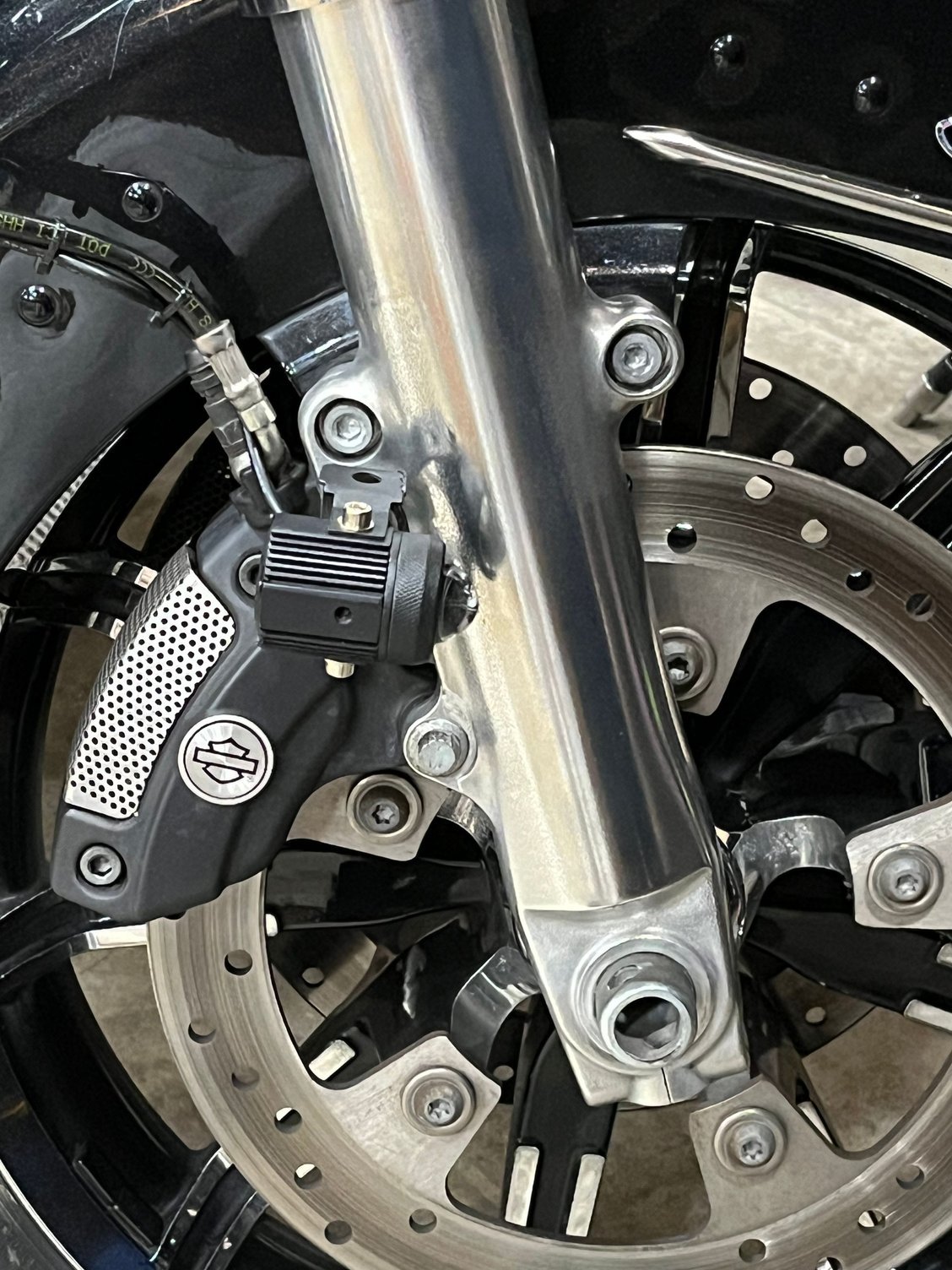

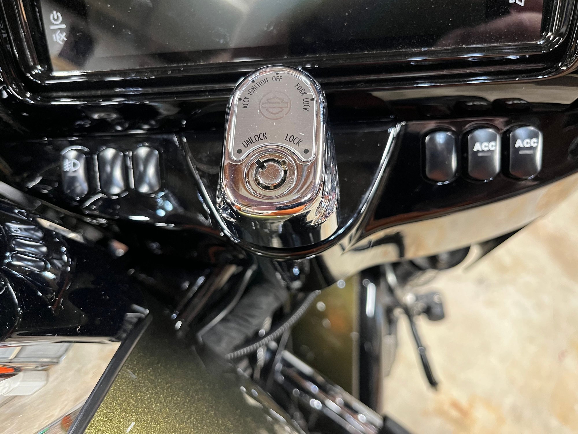

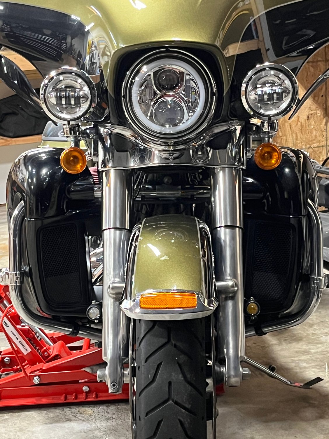

Went and got some inexpensive running lights for the bike. Most expensive part so far has been the acc switches. I mounted the lights off the caliper bolt on the forks. They have 2 settings. White or yellow. Waiting for it to get dark so I can aim them correctly and get better pics. Daylight pics so it no justice.
Harley Part number 714000129. Acc switches
El cheapo 65w Amazon spot lights
Caliper bolt mounted

What brand are those, they don't look like cheap lights at all!

. Ok 60 not 65w as I had posted. Here are the lights on Amazon. I have not seen them at night so I have no review of them yet

Looks good. Yellow lens really pops up and seems visible.

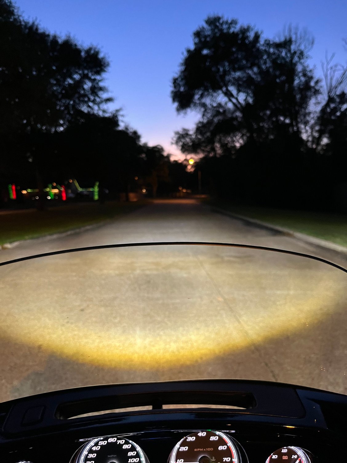

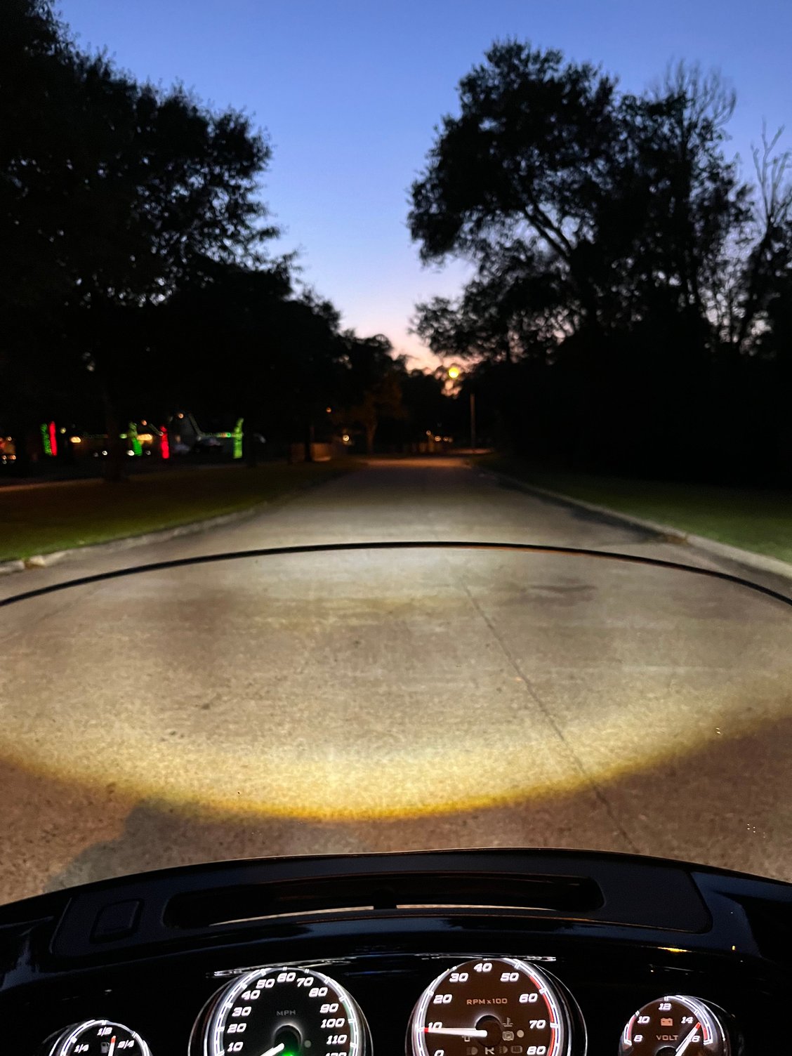

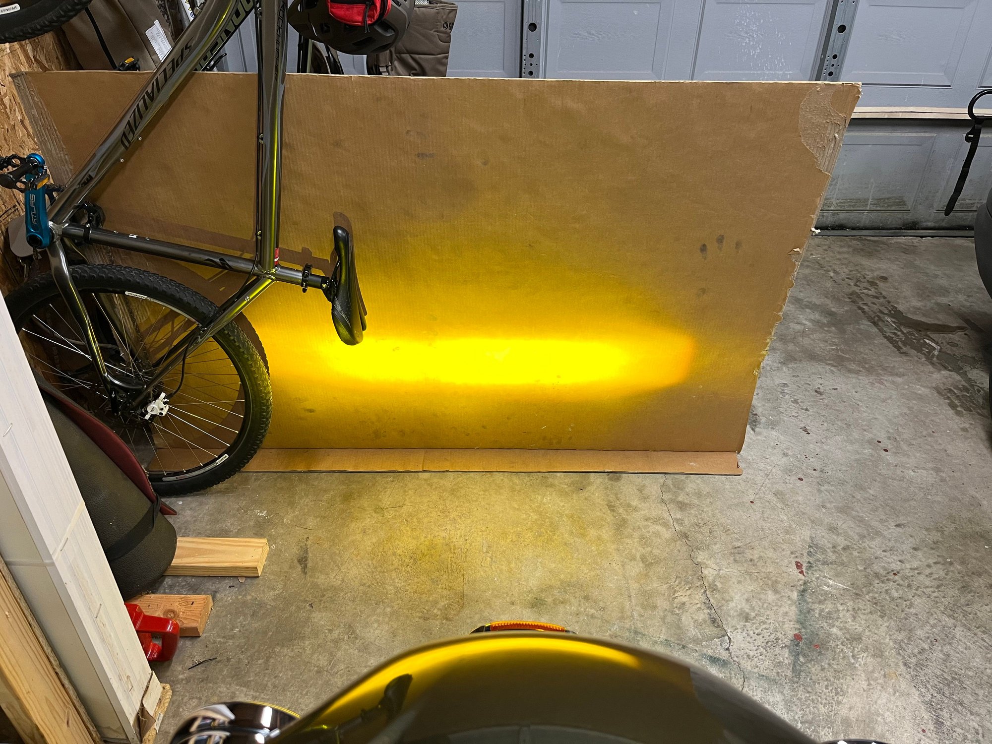

Had a little time this am to line up the lights. Been raining so I won’t take the bike out at night to get them road aimed however you can see the cut off pattern pretty good in these pics

dang those look pretty bright and well made for $20.....please keep us posted how bright they are while riding and how well they hold up over some miles.

Well for the money, they do what I wanted. The white could be a bit brighter on the road but the yellow although still aimed a touch low, I can see glowing in the distance.

First the mounts are crap but that is about my only complaint for the money invested. I will make some new mounts now that I k ow it’s worth my time. When installing mount with the wire on the bottom. This confused me at first because when I look on the glass it would appear as the cutoff line is in the wrong place. A three way switch will work just fine. I bought the acc Harley switches but I am thinking of wiring the white light to the factory running lights, then keep the yellow on a separate switch. That way all light is on for better visibility in day or night. As for using your existing connections, it will just be personal preference. Post pics once you are done. I’d like to see how you mounted them on the bar.
