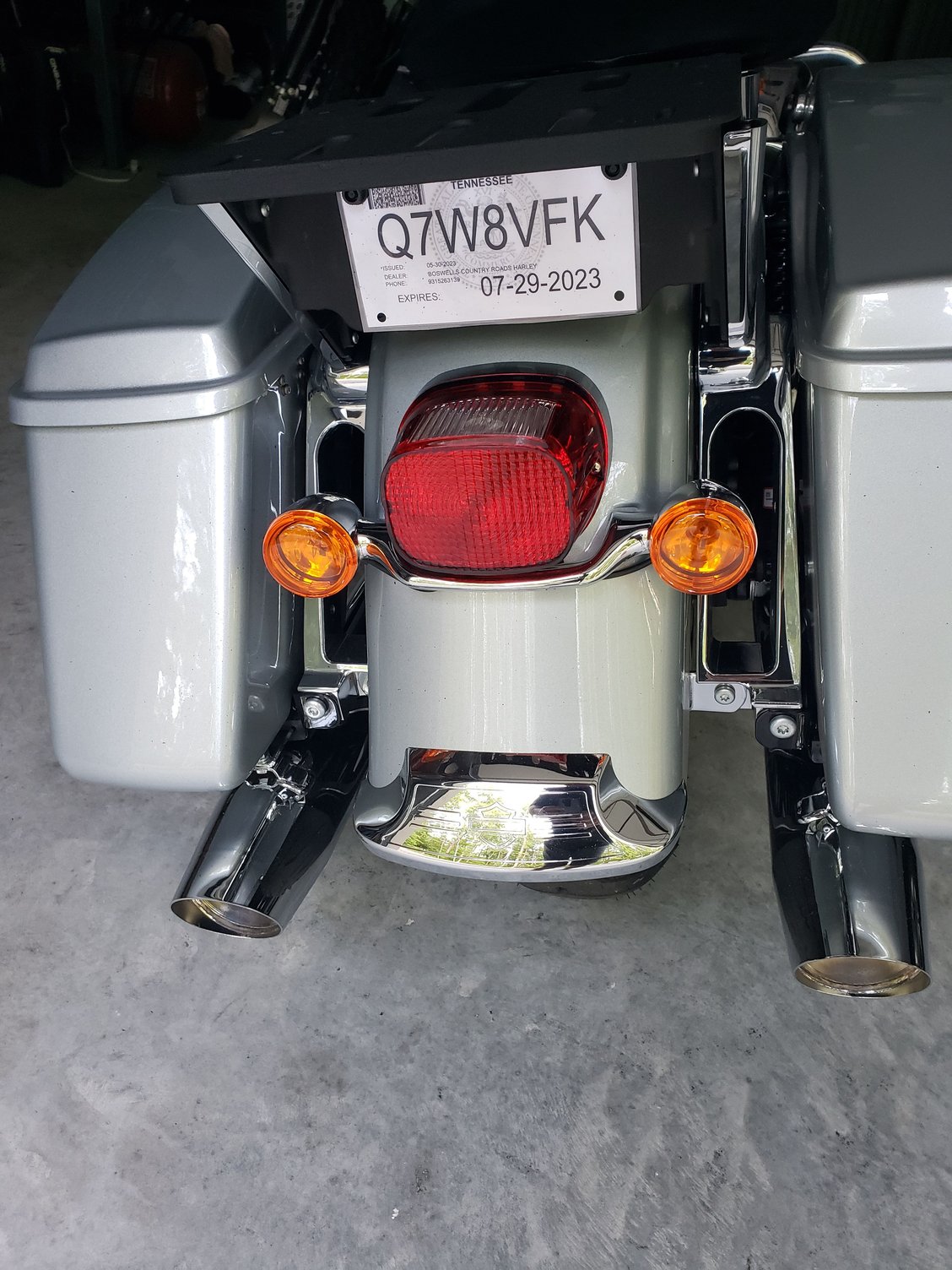

What type of license plate bracket is that? I just got my FLHTP today and really want to move the plate so I can dismount the rack. Thanks
https://www.customdynamics.com/motor...location-mount

I was told by the Harley guys that won't work on mine because of the turn signal bar.

I was told the same. I was advised by a CD customer service that the plate relocator they sell for the road king will work with a little modification. I might try it eventually. For now, the one I have is growing on me.

What type of modification was needed to make the CD license plate mount work? I have heard bending, cutting, etc. Thanks!

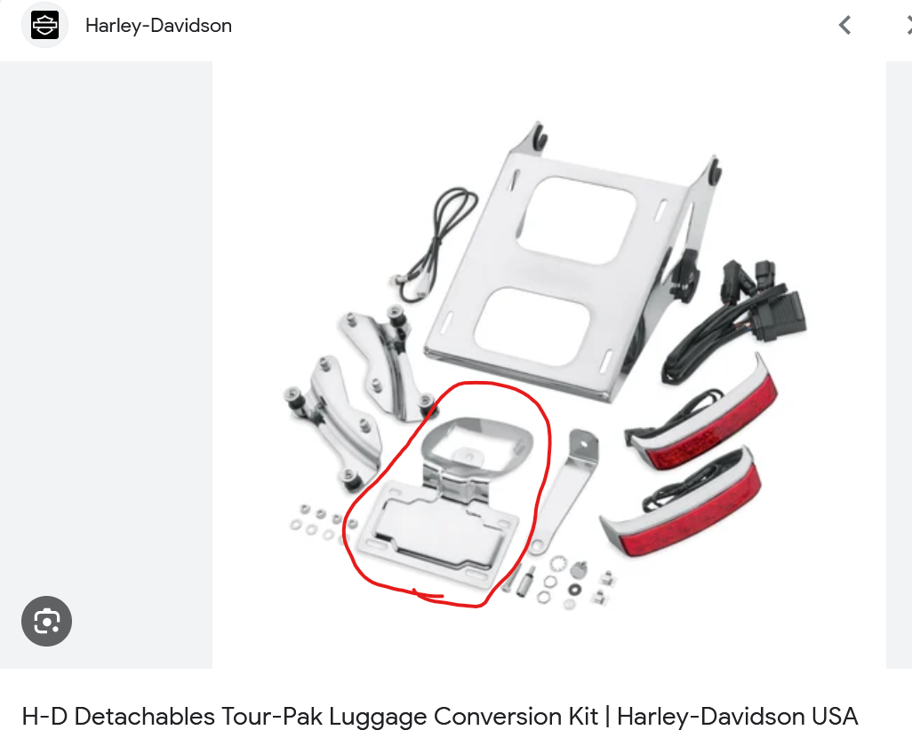

The license plate relocation piece out of a Tour-Pak delete kit should work to allow you to remove the rack and retain the stock brake lite. I bought one separately for my 2015 flhp but can't find the part number. It was quite awhile ago. And i can't seem to find the kit online. your dealership might be able to get it for you.
I just went with a street glide/road glide rear fender and programed the BCM for the change.
edit=I just found the bracket in my parts bin but no part number is stamped on it. sorry...also saw that the OP mentioned the same thing. I payed short money for the rear fender off of a Road Glide/Street Glide that was a brand new take off.

On my 2019 FLHTP, the plate and hole lined up just fine. I did put protective plastic between relocation plate and the fender paint.

Here you go...67900167. I ordered one of these for my RGL last year.
