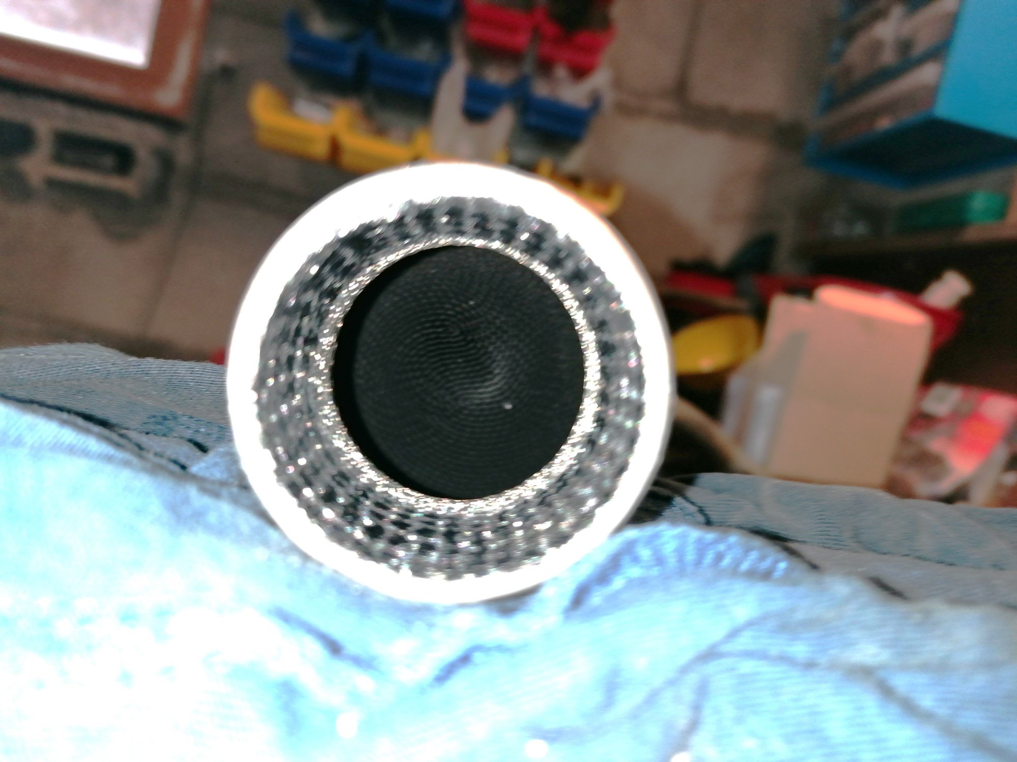

I have a brand new Road King Special and here in France we also have cats in the mufflers, I think it's the same in Canada...
This is the inlet side of the French OEM muffler...
Luckily I was able to get a pair of US OEM mufflers without the cat, a little more rumble but not a big difference, for now I'm sticking with them...
