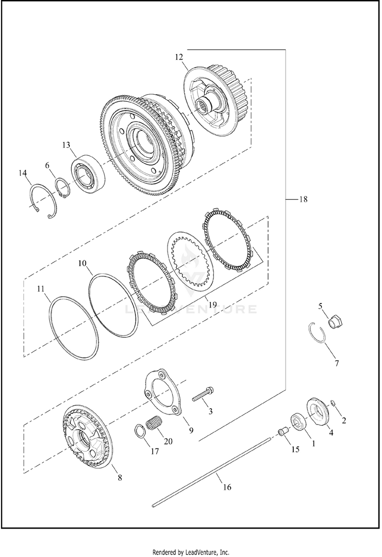

Originally Posted by btsom
Do I understand correctly that the snap ring retains the center plate in the clutch hub? If that is what you are talking about I don't understand the suggestion made above, seems to me he must be talking about the slave cylinder. Wouldn't be the first time I have mis-understood someone's description.
The arrow points to the snap ring I'm talking about.
It retains the release bearing and release plate shown as items 1 & 4 in the diagram below.
