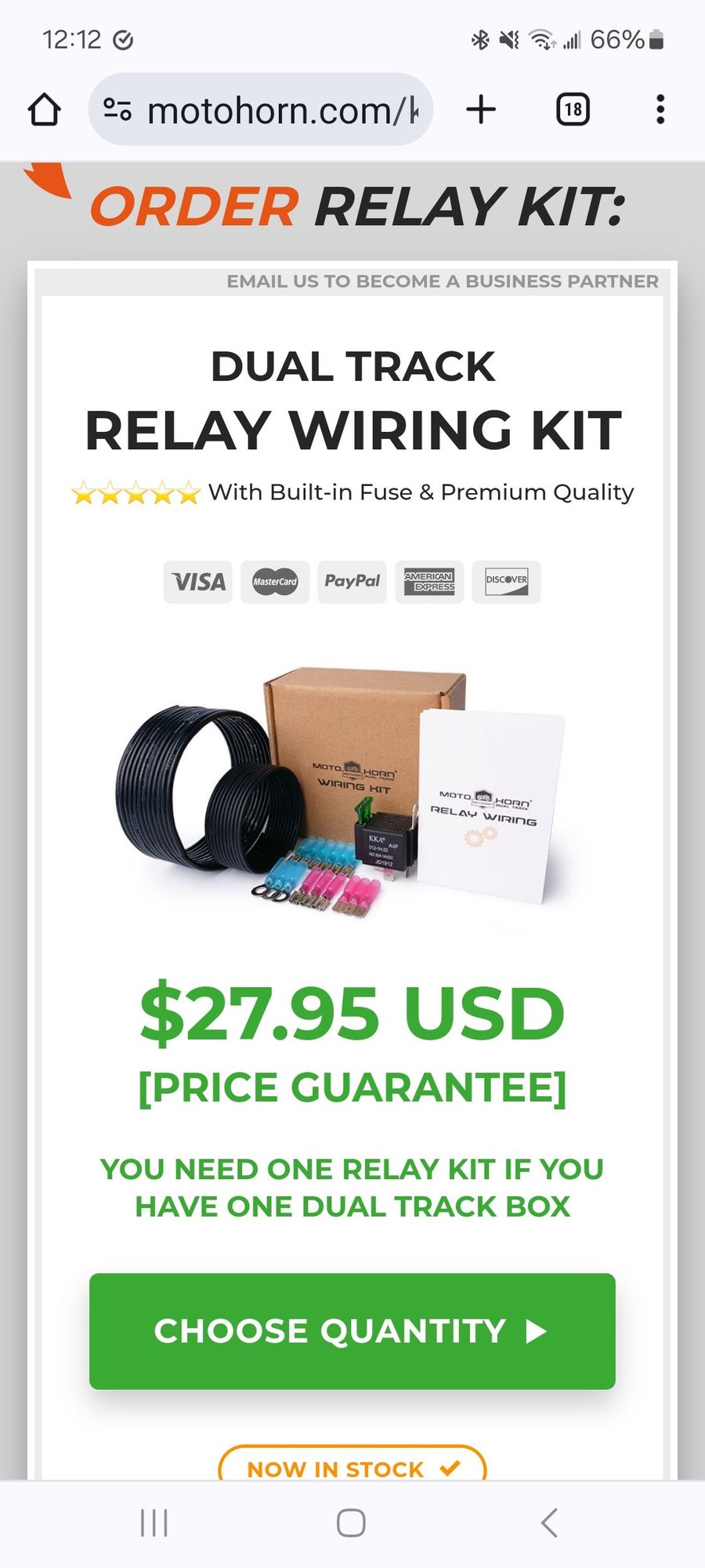

I contacted Motohorn. They sell a complete kit, for less than $28.
That's pretty cheap,free shipping. No messing around trying to find the parts and locating my wiring supplies.

Not bad at all. I honestly thought that it was higher than that.

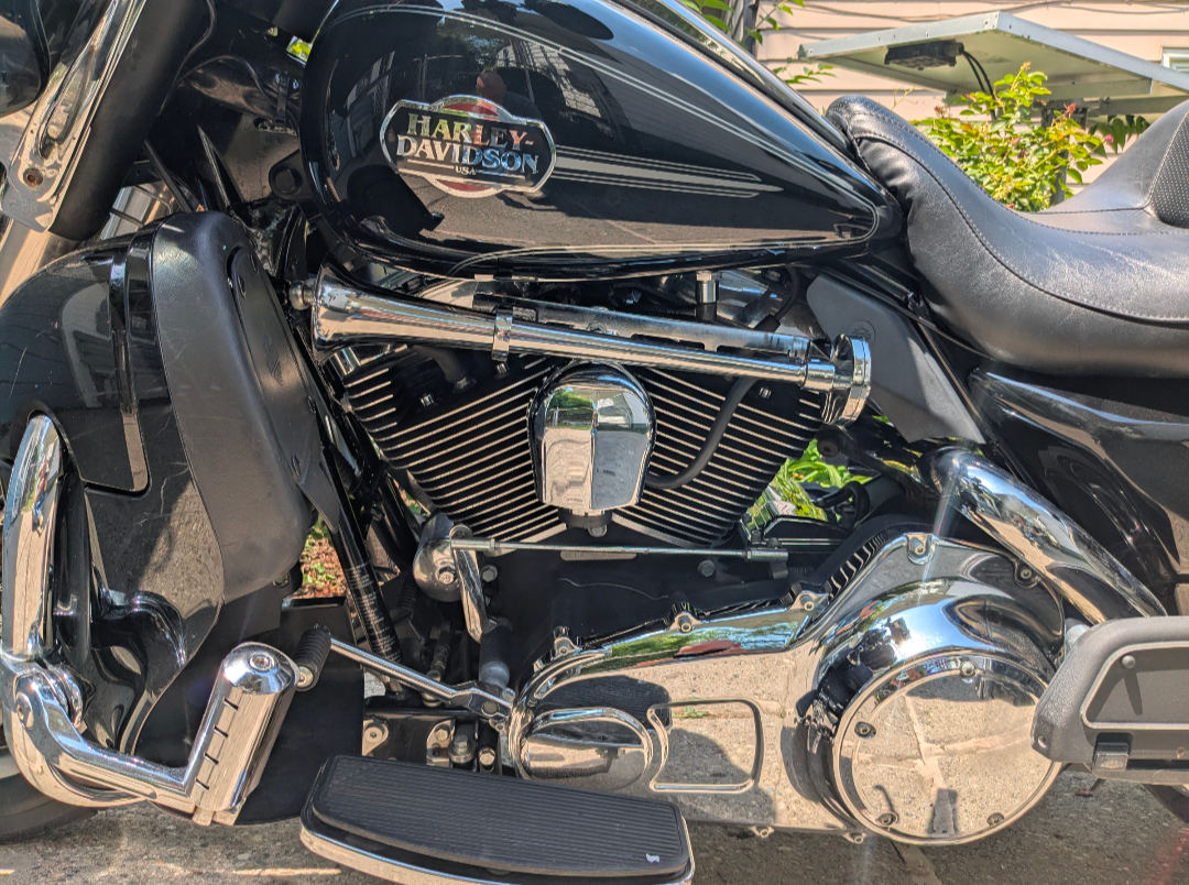

Redrod, I put the Motohorn trumpet in about the same place you put that trumpet - I can see the end of it just before the air deflector just like mine. My leg would hit it when I was putting my foot down. You didn't obstruct me from putting my foot down but was annoying.
Doesn't yours? I did like the loudness but I removed it because of that.

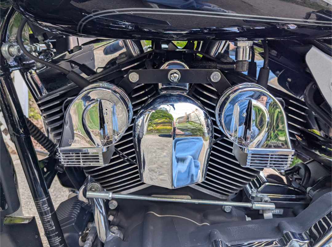

I put the dual tracks on instead. The compressor fit perfectly under the cowbell horn cover after I removed the ridiculous pre-2017 Harley horn. If you zoom in you can see the compressor just peeking out the bottom of the cowbell.
At one time I had all three horns on there but you can really only hear the loudest horn anyway. For some reason I didn't need a relay. I was ready to put one on but I didn't see how they'd be any louder and it wasn't blowing fuses or shutting off until the bike was turned on and off to reset as others have experienced..
Now I just have the dual tracks - a 400Hz and a 500hz along with a Wolo disk low 360Hz under the cowbell. The low tone makes it sound a lot beefier.
Doesn't the inside of your left leg hit the back of that trumpet?
Also that long trumpet mounted only in the center hornbolt vibrated like crazy.
And I think the two electric horns are a cleaner look than the trumpet air horn,
But I probably would have left it on if it didn't hit my leg.
