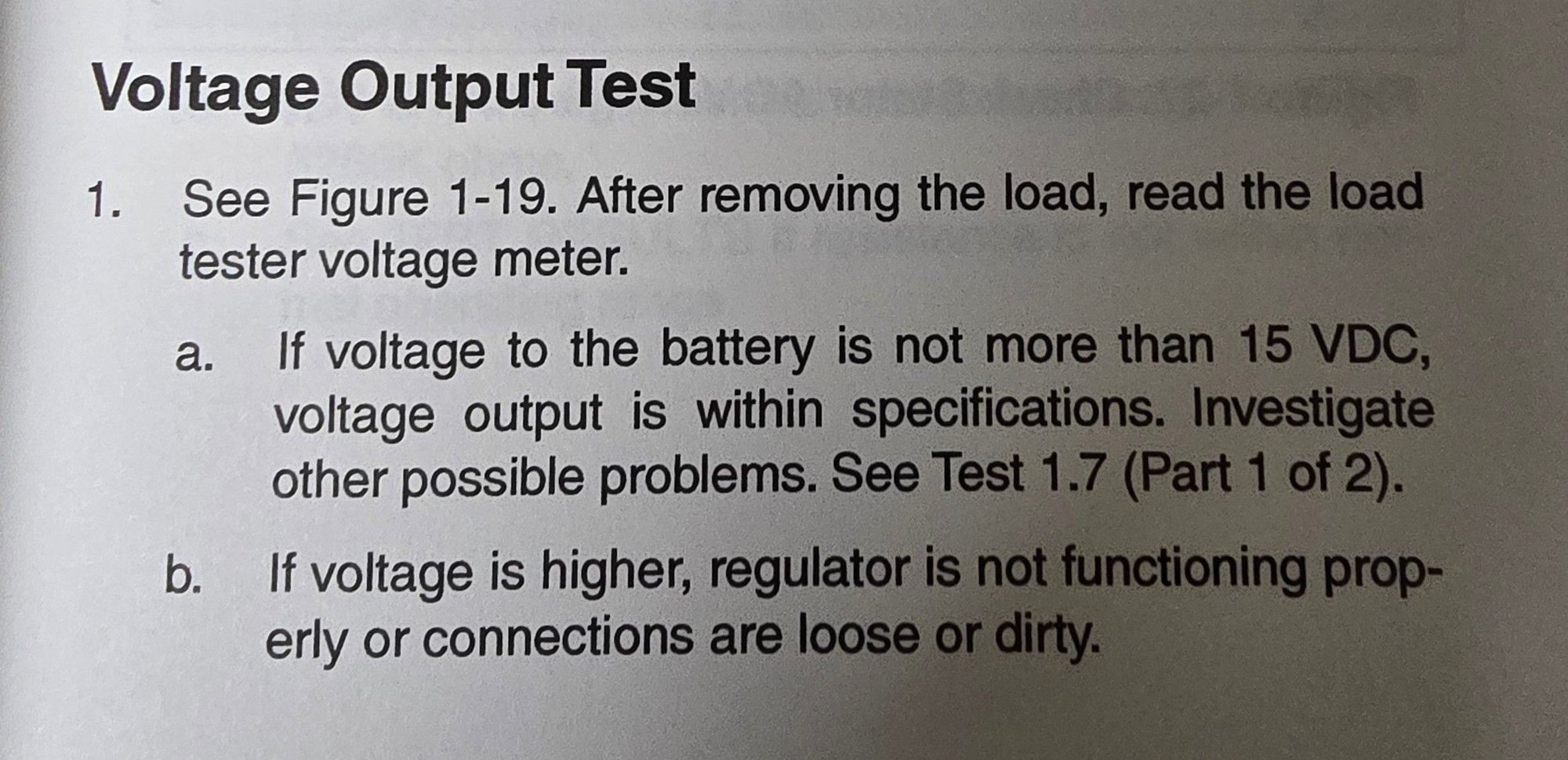

Originally Posted by Rounders
Did you ever put a meter on it? It should not go over 14.4ish when you reved up.
I'm curious..... where did you come up with the 14.4 ish number?
Old Mar 28, 2024 | 03:36 PM
Jackie Paper's Avatar
Jackie Paper
Community Influencer
Posts: 38,525
Likes: 6,406
From: Honah Lee
Typical of most. Out of a Softail TC.
Old Mar 28, 2024 | 04:22 PM
Rounders's Avatar
Rounders
Joined: Mar 2021
Posts: 18,245
Likes: 3,679
From: backwoods
I've been doing this a long time. Its a standard number. 15 volts is for people that don't have good meters. Video below says 14.4
Old Mar 28, 2024 | 05:18 PM
LQQK_OUT's Avatar
LQQK_OUT
Posts: 5,889
Likes: 1,902
From: East Coast, USA
You might be doing this a long time but that doesn't mean you are doing it correctly. Once again, your information isn't completely correct. Why not provide information that's in the Harley factory service manual? Or maybe provide information available from a vendor of voltage regulators?
According to the 2016 Harley Factory Service Manual for Touring bikes:
Regulator voltage output @ 3600 RPM is 14.3 - 14.7 (75 degrees F or 24 degrees C)
According to Cycle Electric, their voltage regulators should run 14.4 to 14.6 volts
I think it's fairly important to provide people with the range instead of an "ish" number.
