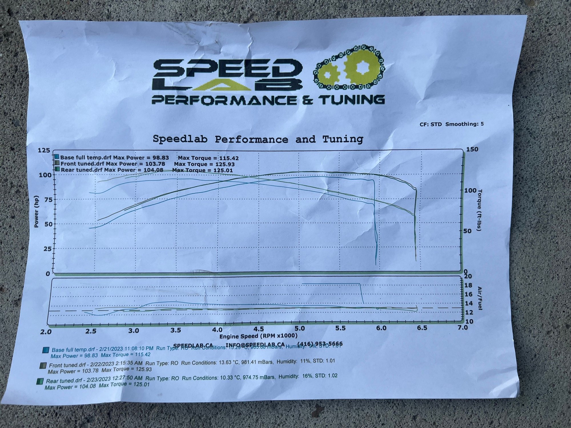

i already had a Dyno stage 2 torque done(pic of Dyno attached 104 Power/125 Torque)

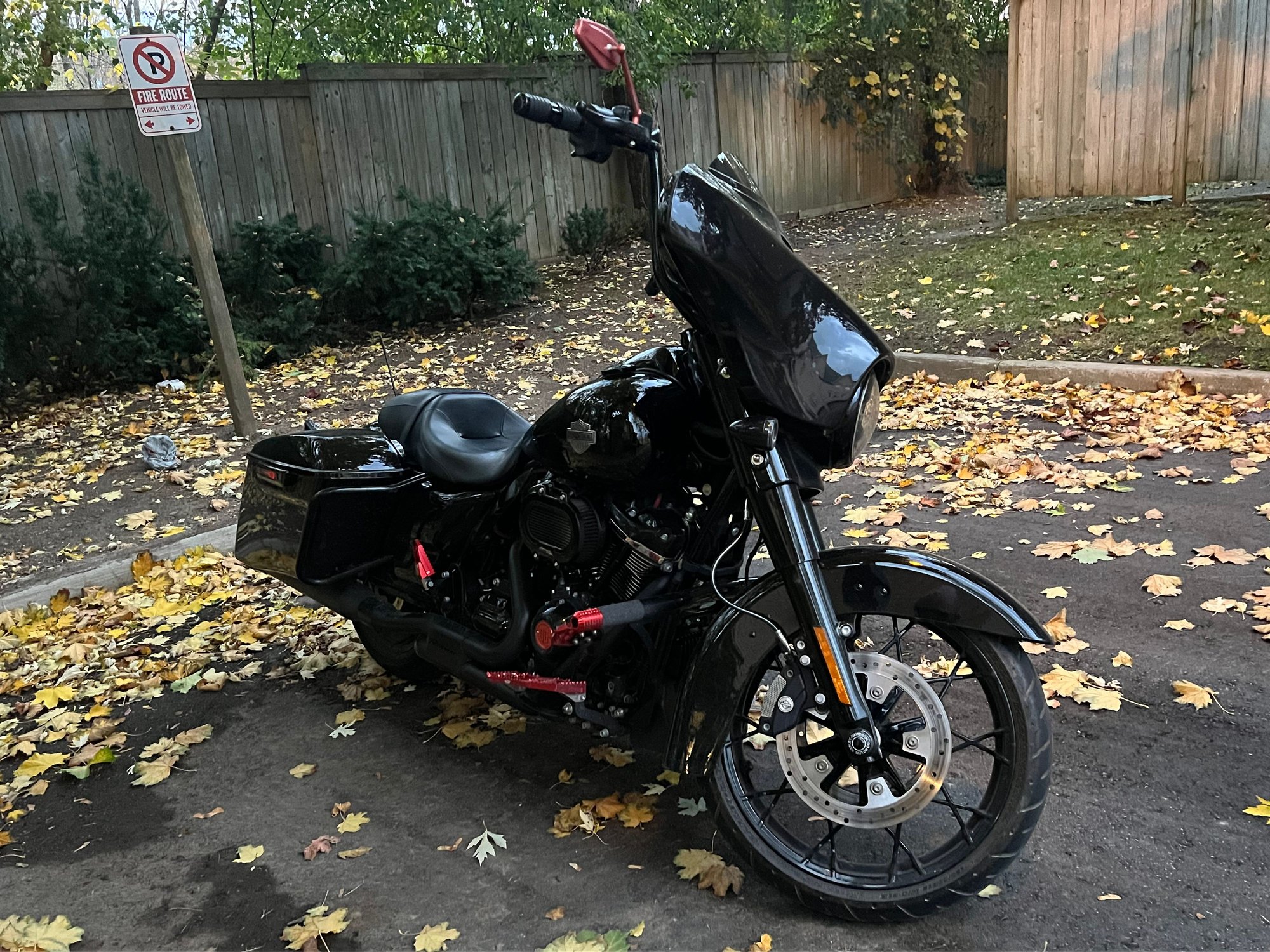

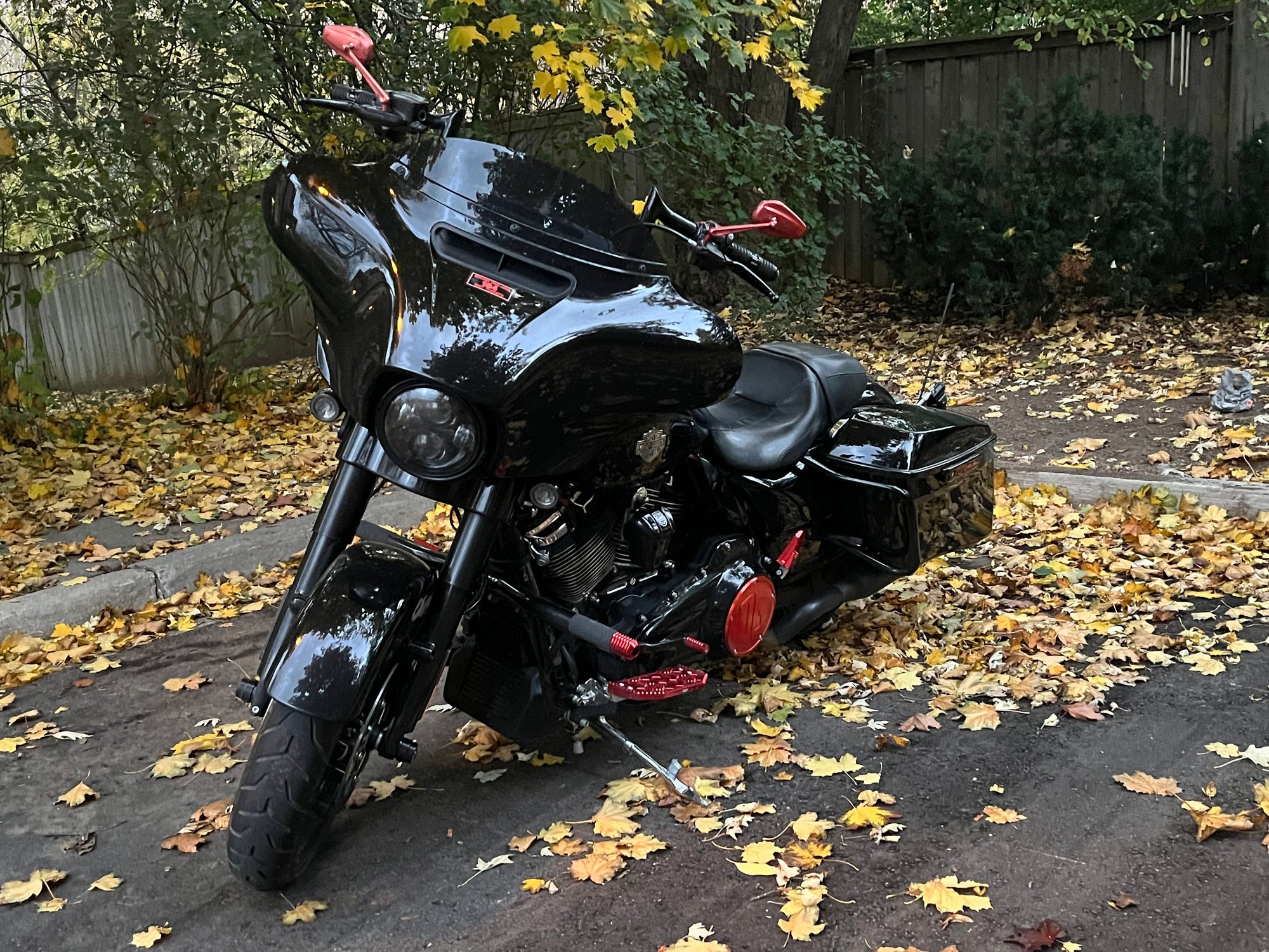

ill attach a few pics of my girl too.(the bike, not the wife lmao)
let me know what you all think. What could or should be swapped. Looking forward to your replies/comments.
Stage 2 Dyno Sheet

Look around the site as there are plenty of builds like yours using various camshafts. The cams you are looking at is very limited and not all showing the results your looking for. Also you should find a tuner that is not using a BS correction factor as STD was rescinded way back in Aug.1988, and was ONLY to be used on small displacement engines of no larger that 50 cu in and making less than 20 HP. You can look it all up on SAE's website. STD correction is J607 "The purpose of this code is to prove a uniform means of comparing small gasoline engines of 0.82 L (50 in3) or less in displacement and 15.1 kW (20 hp) or less in power output. Replaced with J1349" J1349 is the current proper SAE correction that anyone that isn't trying to trick a customer should be using.
