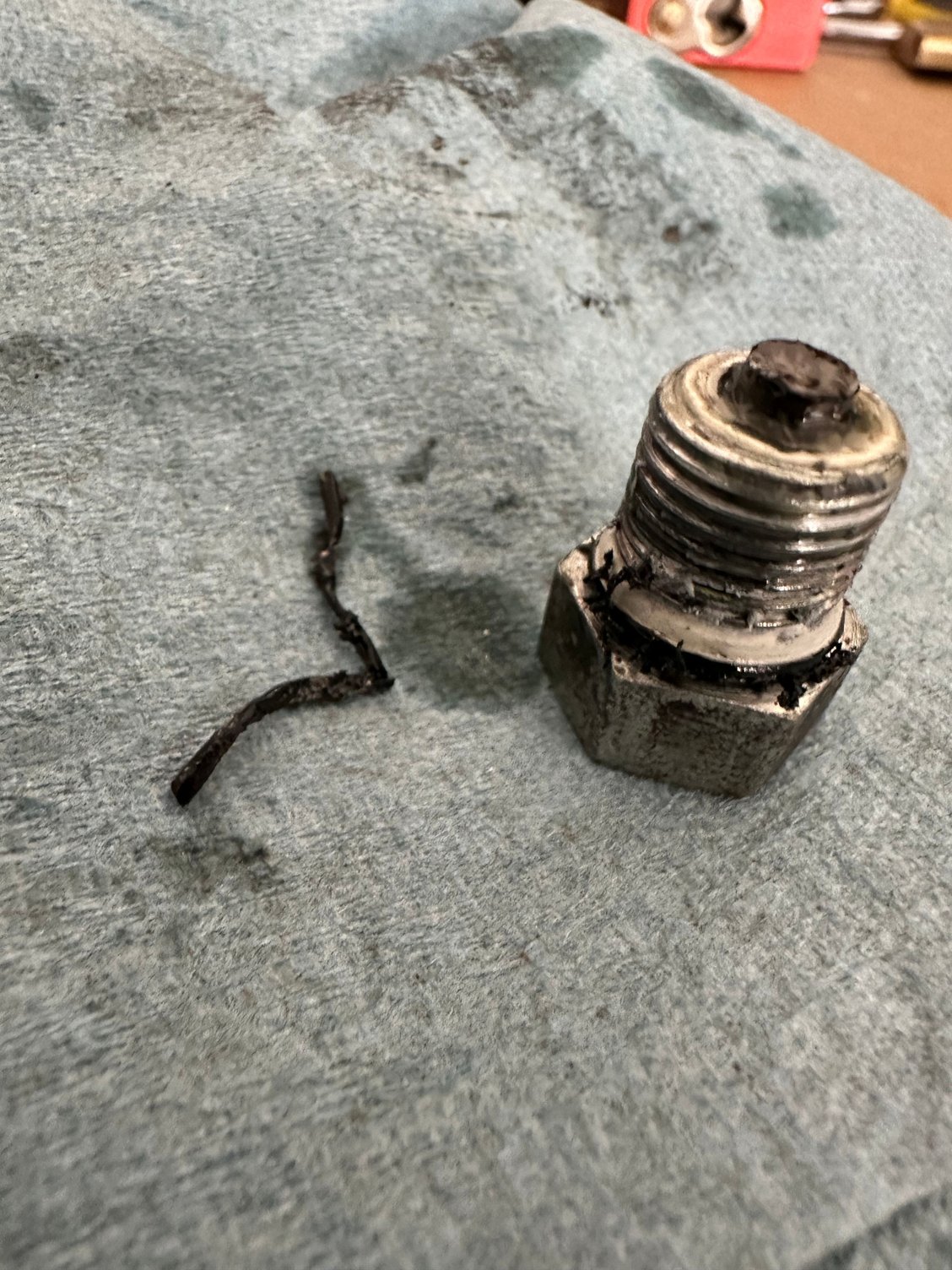

Update: I drained the trans. Opaque fluid and 24 ozs came out. So about 4 ozs short. Very little metal if any on the magnet. An O ring was on the plug and intack but it looks like the tech added teflon tape (white something) to the threads and either never removed the O ring or added a 2nd. What I don't get, if the drain plug was the source, then why is the left side rear mostly free of oil? The belt is clean, the slip on and under the bag is all clean. However, the right side rear, the slip-on is coated underneath with oil along the length and the underside of my bag was coated with oil.
I cleaned up the underside and inspected around the drain plug. No cracks. I rechecked the oil, it's at the proper level given the big is on a stand. I have not opened up the primary yet as I need to pick up a gasket and a quart of 20/50.
I'll pick up an O ring ++ tomorrow and fill up the trans and go from there.

It's hard to tell from the picture but the threads on that plug look strangely worn. It's possible that it just has teflon pipe dope (same stuff I use and the factory uses) on the threads and that's making it look different.

When too much teflon tape or paste is used on a drain plug, it gets pushed up underneath the o-ring during installation. This causes the o-ring to get cut, leading to failure and leakage. The OP's photo shows exactly that. The o-ring is what provides the seal, so tape/paste isn't even needed. I don't care what anyone says, and I'm not going to debate it. If you use it, good for you, be happy.
