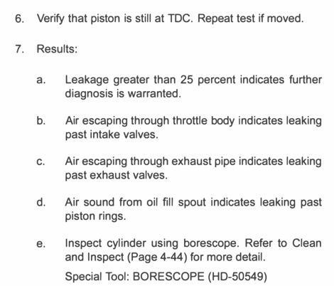

Originally Posted by Keithhu
That is correct. Its there in black and white in your service manual. (2020, at least, but I doubt it has changed)
Wow.Thanks Keithhu. That basically voids warranty. I'll keep you posted with the leak down. I'm not going to roll over on this issue. They are going to have to make it right. Even if that means a deeply discounted 121.
