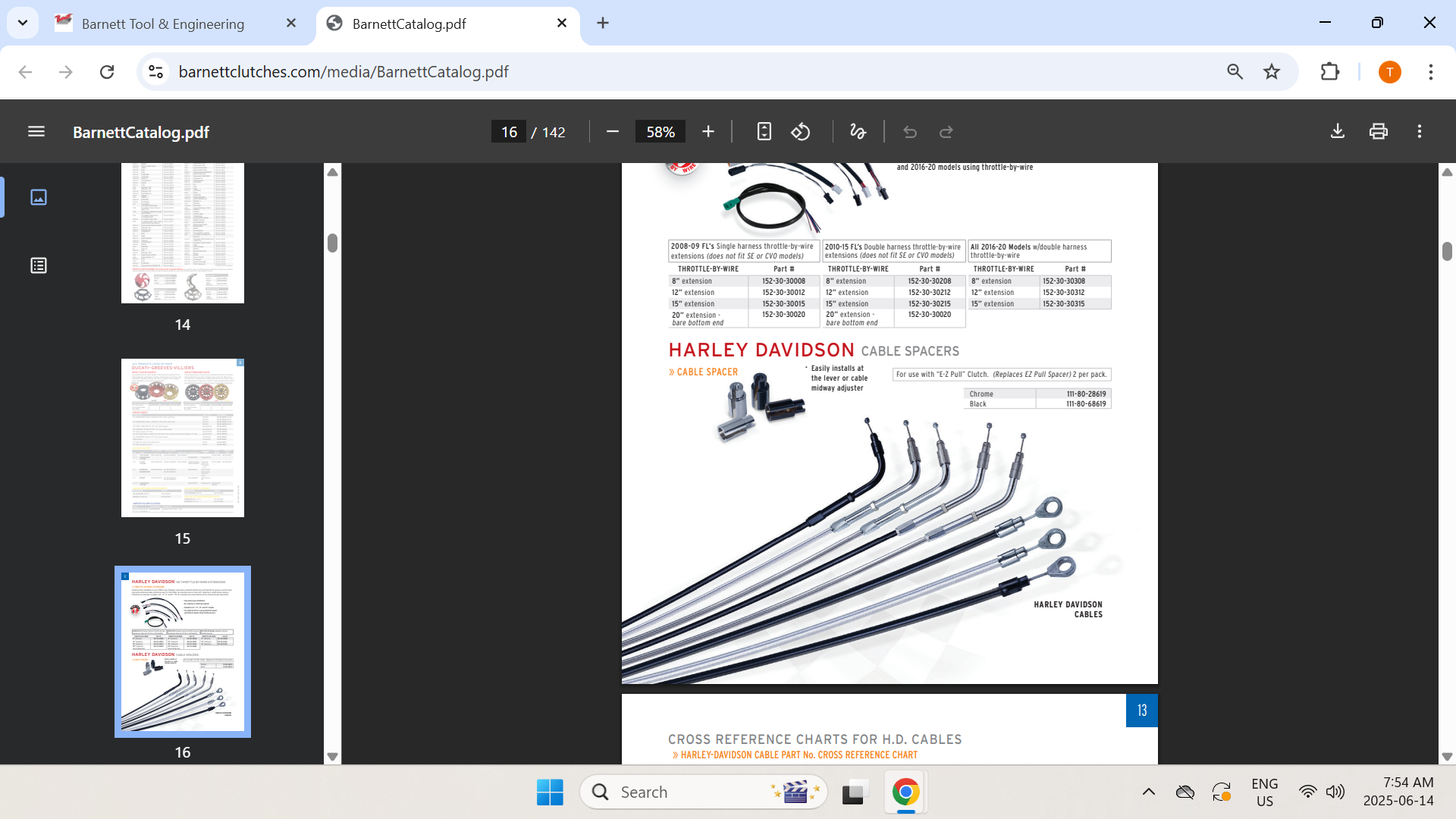

’14 Road King (this model still had clutch cable). Every few years I do the clutch cable adjustment, Open the Derby cover and do the procedure for clutch plate engagement then adjust the free-play with the cable. Loosen the adjuster nut end move the large nut down to allow about 1/8” free-play at the clutch handle. I only have moved the large nut down over the years and I actually went past the end, screwed it back up 2-3 threads and have about 1/8” free play. If I do it again in few years, there may not be enough threads left. Is there a way to remedy this or do I need a new clutch cable?
Here's a screenshot from Barnett clutches website that shows what will fix you up on the spot, "cable spacers". I had apes installed on my 06 electra in 2023 and was also struggling with clutch issues that led me to having to adjust the cable to the extreme end of the adjuster tube. To shorten the story, I discovered these easy to install cable spacers that cost only a few dollars. I would have had to scrap my brand new cable and spend hours to install one that fit properly for my application, this ingenious little item was the perfect answer. I was shocked that none of the shops around here even knew about this fix. Good luck
