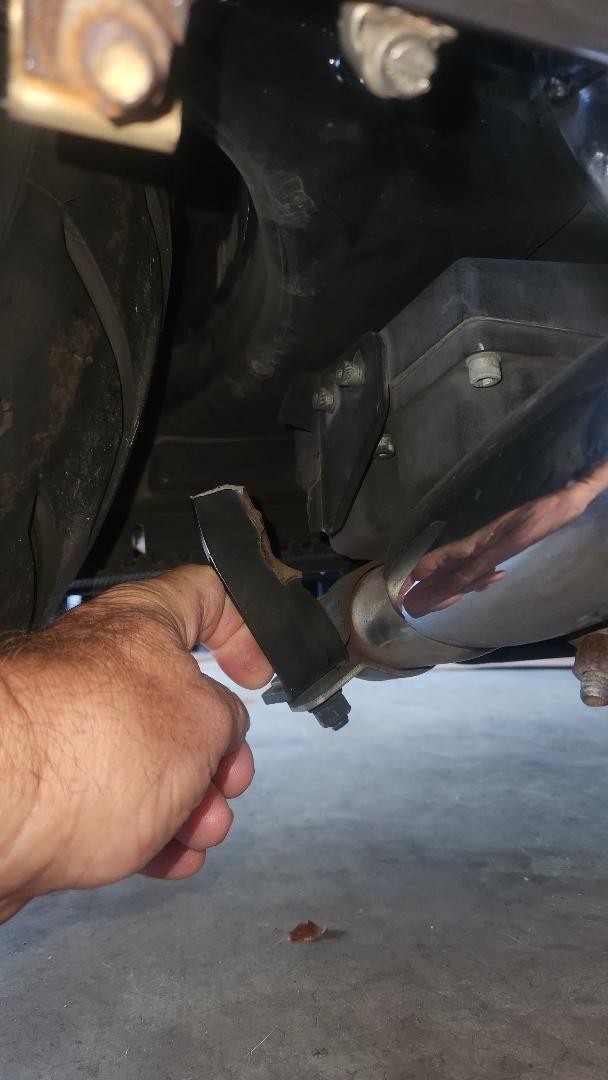

I walked up to my 2014 Electra Glide and noticed this exhaust bracket hanging... see pic. I'm sure there is a specific name for this bracket. Don't need to bring the bike in, just like to know what it's called so I can order one and install. Thanks,

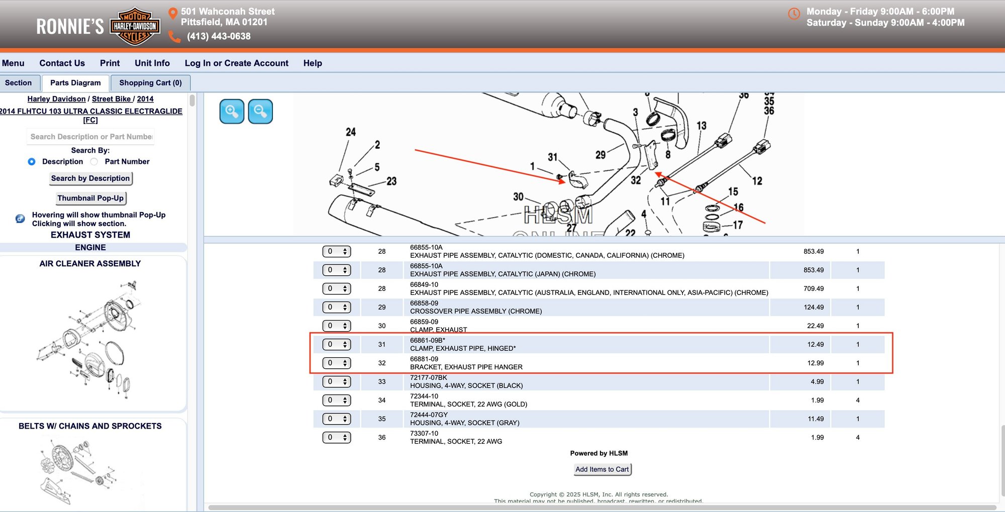

This should take you to the parts finder for the parts you need and corresponding part names/numbers.
https://partsfinder.onlinemicrofiche...avidsonmc/1267
If it doesn’t, start here.
https://www.ronniesharleydavidson.com

Hard for me to tell from the picture but I don't think that's OEM.

not OEM. whats the brand of your exhaust?

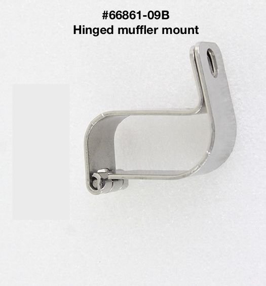

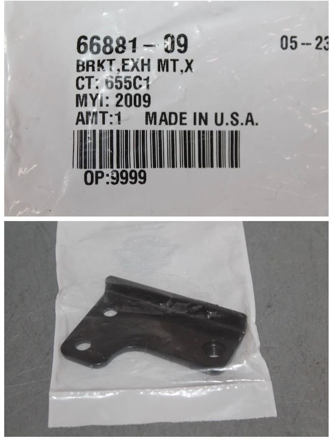

As a couple have mentioned, that is not the OEM mount from a 2014 Touring bike. You'll need to contact the exhaust manufacturer for a replacement.
Here is what your OEM #66881-09 bracket and OEM #66861-09B hinged muffler mount would look like.

remove it and weld it up

V&H? Looks like classic V&H breakage, and if so, you will need to weld it most likely.

I had my aftermarket V&H bracket crack, they no longer made the bracket so I took it to a welder who fixed it right up and put in extra support at the crack location to ensure it didn't happen again. Held like a champ, at least until I wrecked the bike.

Had that happen on a V&H they sent me a new and improved one for free.
