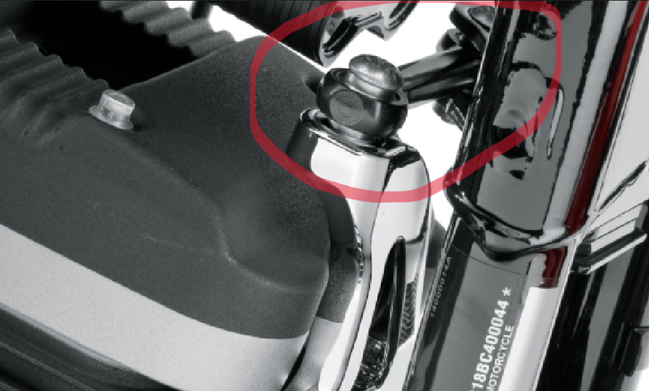

Does anyone have a picture of the joint area?

Can't say for sure, I suspect the isolating cushion within the joint is rubber rather than neoprene. Oil on rubber is a bad idea, silicone would cause less deterioration over time.
The cushions that support the back end of the mufflers are prone to chirp as they wear. Sound reflects off a fairing and windshield making stray noises difficult to locate. When the exhaust system is cool, push and pull the back end of the mufflers left and right, up and down and see if the chirp repeats. Exhaust system clamps, the full length of the system and heat shield clamps are also prone to chirp. Closely check the exhaust system from front to back for being close to the frame, foot boards, or any other component. There might be a corresponding satin wear mark where there is rubbing. Other components cushioned with grommets are also good candidates. I had one that took a couple of years to find, one of the bolts holding the cover over the swing arm bushings had loosened slightly and would chirp intermittently. Retorquing to spec. cured the problem. Almost anything can chirp, front fender mounting bolts, crash bar mounting bolts, saddle bag grommets and support cushions. Anything that isn't welded can chirp. Good luck.
