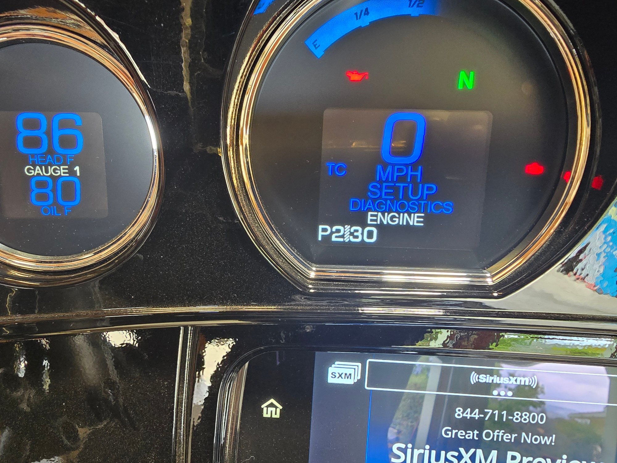

Anybody seen this weird code before??

Just installed a new set of Dakota Digitals on the 22 SGS and when I was done, I decide to run a code check to see if there was anything weird on there because I had just done a battery swap out a few days prior. The usual suspects popped up and cleared easily enough, but this guy is on there and WONT clear. WTF is that 3rd digit, lol? Any thoughts?

Just guessing but it could be a P2130 which is a malfunction in the Throttle Position Sensor (TPS) or its circuit.

Yeah, that what I found when I looked it up too. But doesn't really make sense as I was nowhere near there...... But that barber pole thing is still on the code even though I've cleared it 3 times.

That's the symbol for "ur screwed" ??

It could be unscrewed....... we don't know the rotation of it, lol.............

Send the picture to Dakota Digital as ask them as it's there display doing it.

Yeah, I think I'm going to have to get DD involved...... thanks Steve.

DD Tech says I need to see what an actual DTC reader says when I pull codes. He couldn't find anything on it either, but I sent him the pic and he said he'll look into it.......

Getting a code reader is always an issue unless you can use a dealership to get what DT says. Lots of code readers these days give bad information. If you have access to a TTS unit it will read the codes on any bike that the unit fits.

put the original OEM Speedo (or what ever it is) back in and see what happens.
