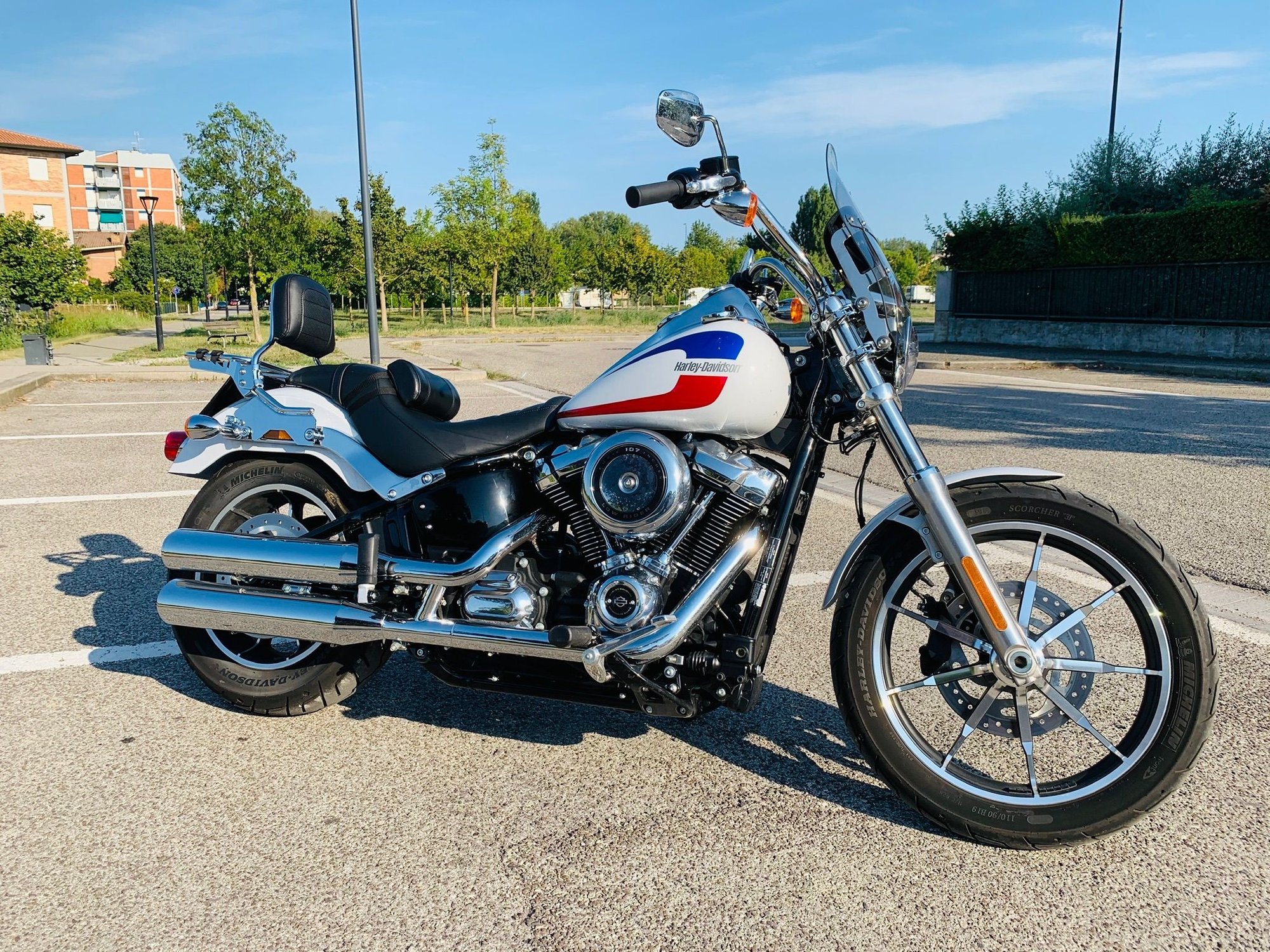

Swapped handlerbar, now the heritage one is on. more pullback / riser. Feel confortable, now can sit fine using all the back support. The added back pad is no longer need, will go soon
Added front brake line extrnsion and turn signal wire extension, 4 hours job

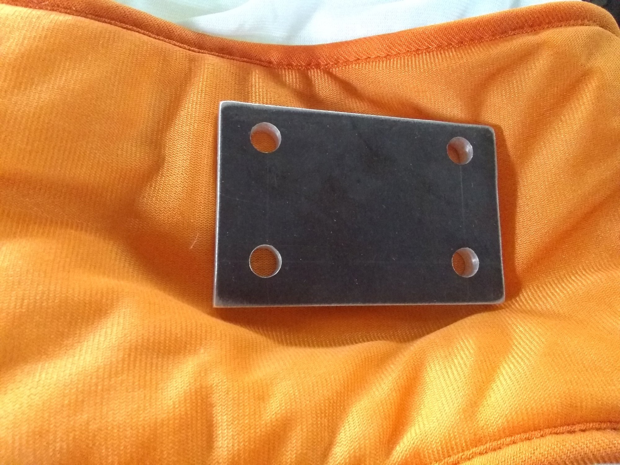

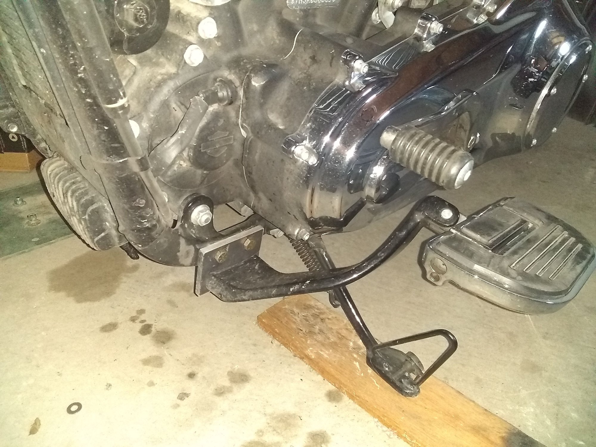

This is the plate from the left side... I ended up with a "spare" because I didn't realize the bolt pattern was different on the right.
Made from a 1/4" piece of 6061 aluminum.

Great fix. On my Lowrider, with the "mid controls", after 25 miles, I was cramping up. After 50 miles, it got painful. After that, it was dangerous. I went with the forward controls, which allowed me to log as many as 500 miles in a day (with a back rest) with little to no problem. But, if they had another inch or two, of extended leg room, they'd be perfect. Seems you nailed it.
