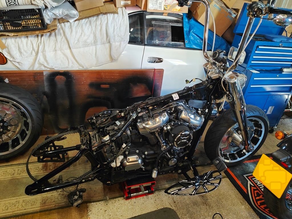

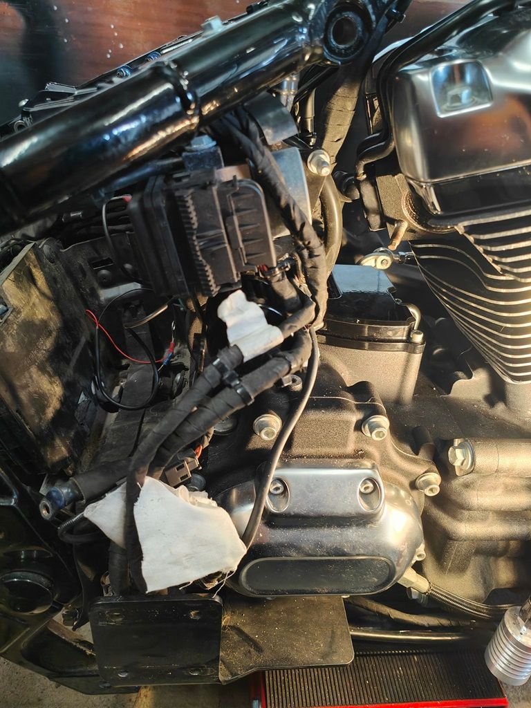

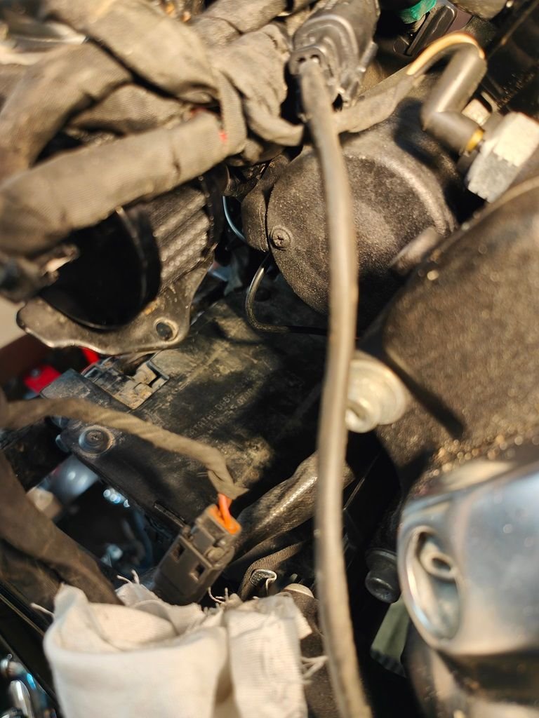

So I've taken the bike off the road and started my project

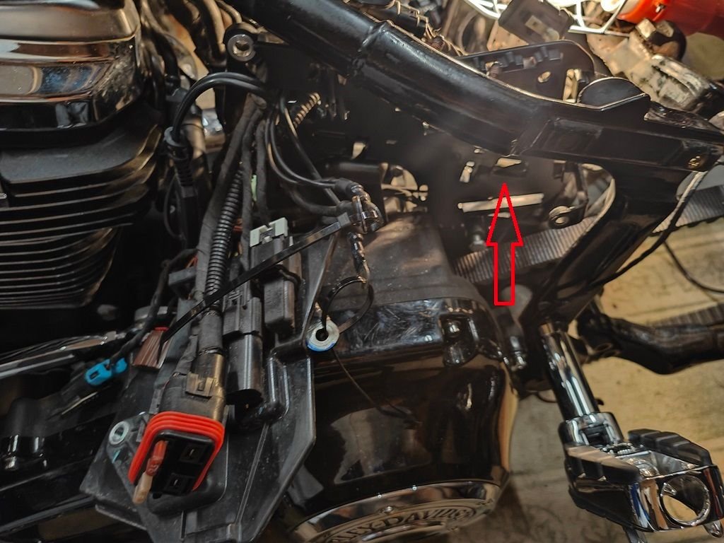

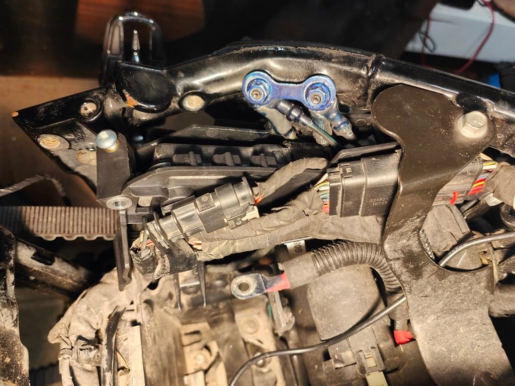

First up was replacing the ECM Caddy Assembly (OEM 69201519/69201638), as arrowed below.
Jeez what a mission that was! - the amount of connections you have to unplug and detach never mind the routing of the wiring - took plenty of pics for reference.
Battery has to come out to get to 2 locating screws.
Luckily I'm replacing the rear suspension so having that out the way helped with access.
Anyway, got there in the end

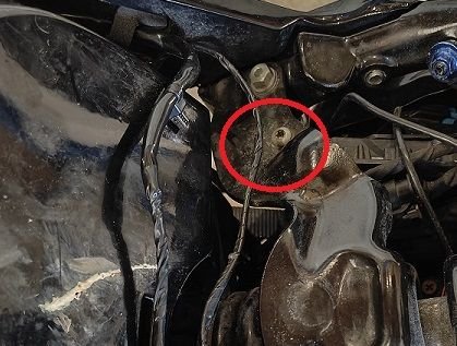

Why did I replace this?
All because of one screw that had been overtightened/Loctited in which I ended up having to cut the head off to get the cross member off.
Old
New

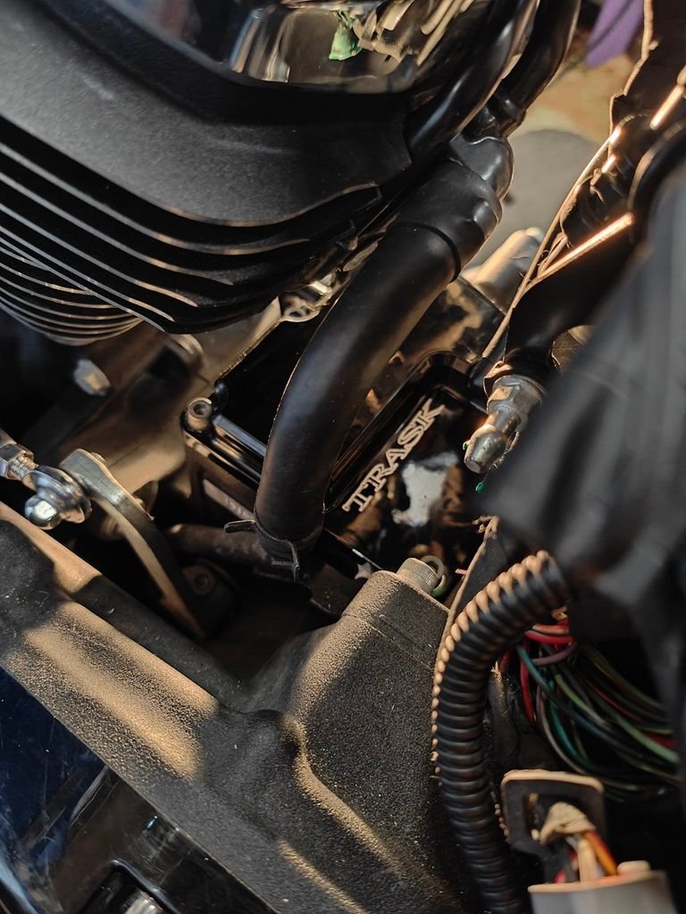

Removed the V&H shortshots (non-PCX version) exhaust system
Fitted the Trask M8 Transmission Breather cover
Mounted the filter behind the wiring and where the bracket for the adjustable suspension damper was (no longer required as I'm going Air Ride)
Fitted the Muller Power Clutch and Gloss Black Transmission cover
Fitted the V&H Shortshots PCX version (chrome heat shields to be done)
