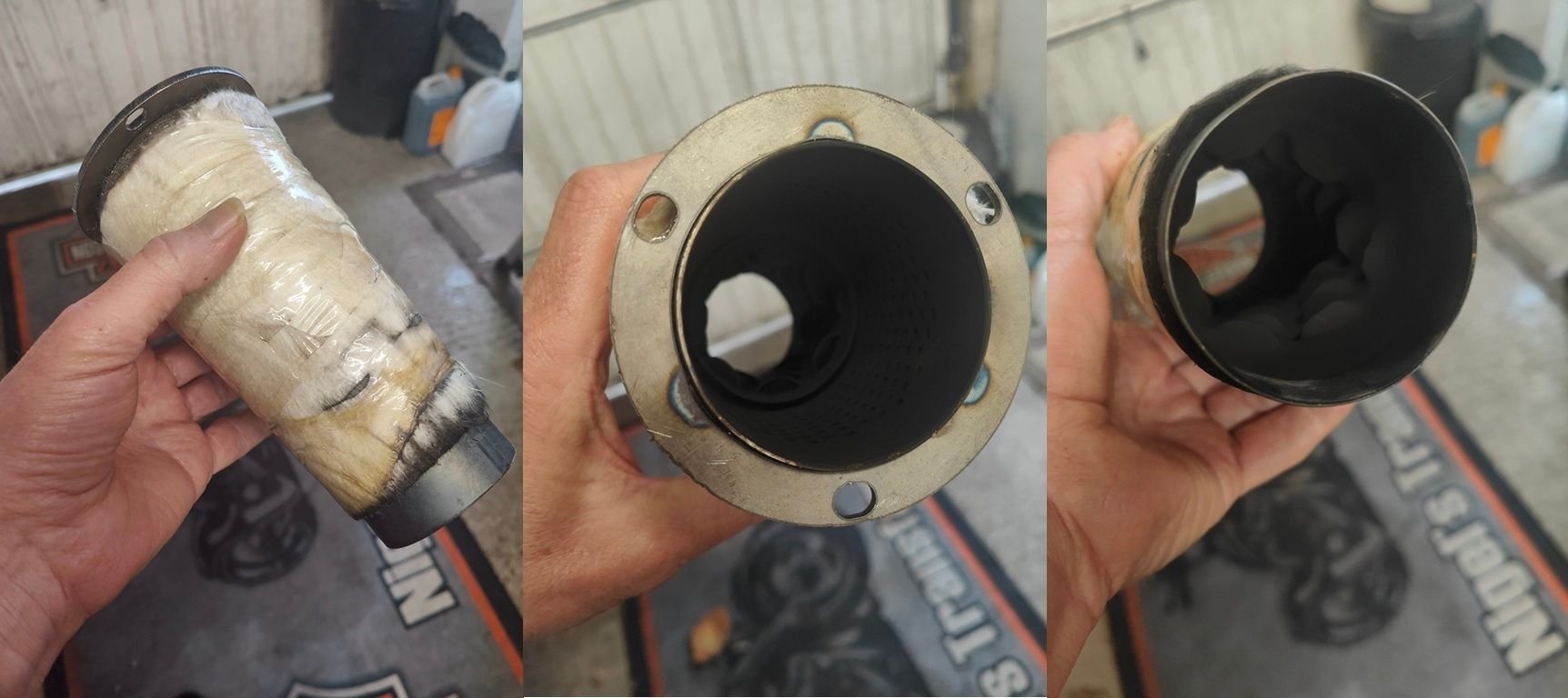

Holy Sh*t it's f*king loud (I'm DEFINITELY going to need to buy the quiet baffle otherwise the cops are going to be pulling me over every 5 minutes)
Now I know why!
Just ordered an FPE Quiet Baffle which should turn up tomorrow
According to the blurb it should ibe 5-8dB quieter

Installed the FPE Quiet Baffle this morning and took it for a spin
WOW! What a HUGE difference!
It still has that deep exhaust note (but not as obnoxious as before) but the difference in the ride is phenominal!
I can roll off the throttle without it going all "lumpy" and can "pretty much" ride it at 30mph in 3rd; 40mph in 4th albeit it still wants to pull.
I now know and understand the reason with regards to my previous comments about it being so "lumpy" and having to be "on the throttle" = reversion
I may well experiment with the standard baffle by putting in a DK Customs TTI
...but, to be honest, I'm more than happy with the way it is now.

Cant speak for your personal experience of course, but I'm on my 3rd fat boy and on pretty much all 3 of them I would consider 30m mph in 3rd gear to be darn close to lugging the engine
and would feel pretty lumpy with a high performance cam, and I'm not a high speed, high rpm guy. I like low rpm cruising but if I get much below 2k its feelin lumpy
What are your RPM's at 30mph in 3rd? Under 2000?
