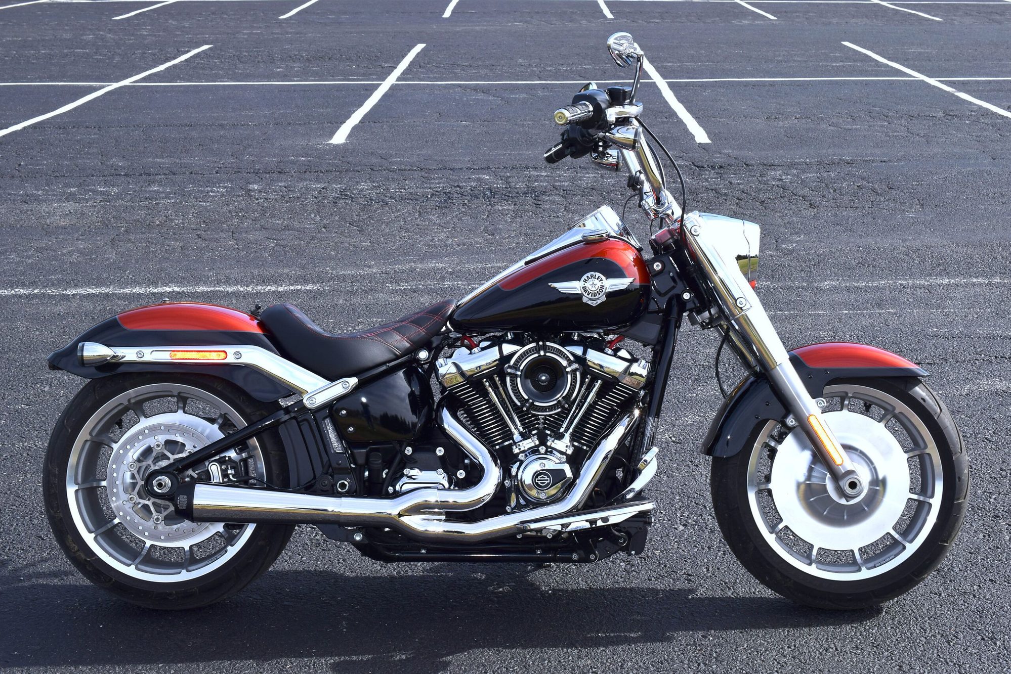

Stage II complete.
Picked the bike up yesterday afternoon/evening and rode back 90 miles
Holy Sh*t it's f*king loud (I'm DEFINITELY going to need to buy the quiet baffle otherwise the cops are going to be pulling me over every 5 minutes) and it just wants to pull.
Going to have to get used to riding it - where as before 30mph was 3rd gear; 40mph was 4th gear; etc., now it's a case of having to be one gear down, i.e. 30mph in 2nd gear; 40mph in 3rd gear; etc., otherwise it's just too "lumpy" and wants to pull.
...and YES it's f*king quick right the way through the rev range.
Cruising the Motorway (freeway) in 6th at 70mph, open the throttle and it takes off like a scolded cat.
The color of the air filter cover is far too much - sticks out too much - so going to get my painter to do his magic.
Took the bike out for a spin today and just wanted to clarify my statement above.
Riding in restricted mph zones (when trying to keep to the limit) is when I have to be down a gear to be able to keep it on the throttle, any let off the throttle in the higher gear is when it gets "lumpy". Twist the throttle in this high gear and it just wants to take off.
It's an absolute beast now...
and goes as good as it looks
Exhaust looks like the horn for a battleship
Whats that rear fender? Looks great
Prolly part of the reason it sounds so loud to you is its so short. Mine goes to the rear axle. If I stand behind the bike its loud, but when I'm on it its not as loud
Sounds like it too
Thanks
It's a Thunderbike Rear Fender Steel 260 mm with integrated tail/brake light and indicators
Yes I reckon so but I personally don't like the look/aesthetics of the long muffler exhaust systems albeit they are meant to be excellent/better gains when running higher horsepower.
